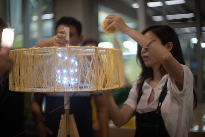

The Little Universe, a Gesture-Controlled Floor Lamp
The Little Universe is a gesture-controlled floor lamp with three wooden legs and an artistic lamp head.

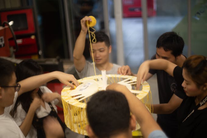

yellow flaxen thread
