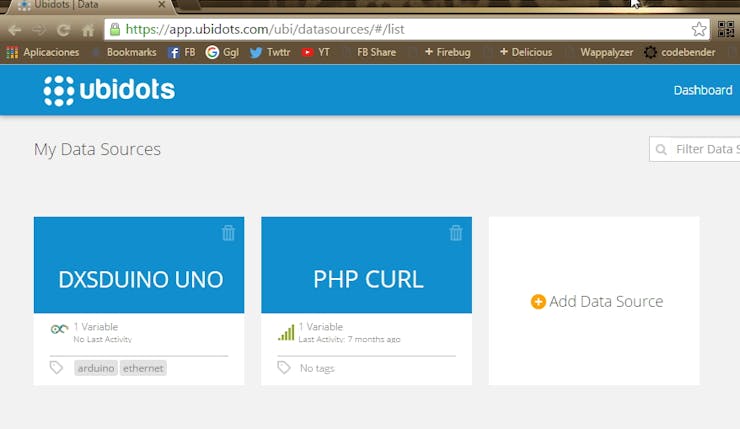

Installing Ubidot Library
Python
For use the Python Ubidot API, on Embedded Linux

Collect and Send Data
Python
Monitoring the sensor value, and sending to data service.
