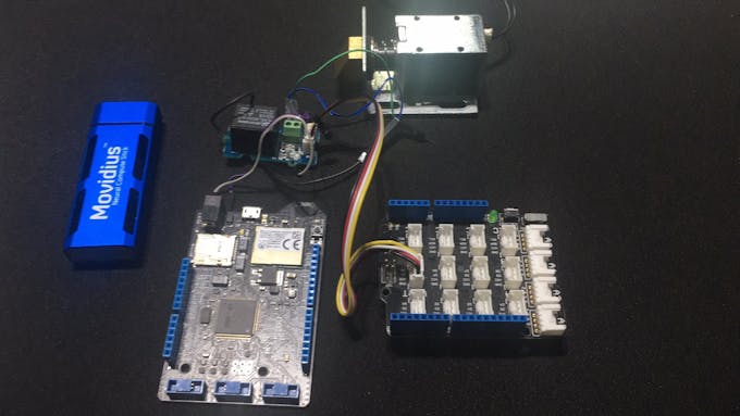

Things used in this project
Netduino3
Wilderness Labs (Netduino) Netduino3
×1
Camera (generic)
×1
Movidius Neural Compute Stick
Intel Movidius Neural Compute Stick
×1
Base Shield V2
Seeed Base Shield V2
×1
Grove - Relay
Seeed Grove - Relay
×1

Schematics
Netduino Lock Diagram

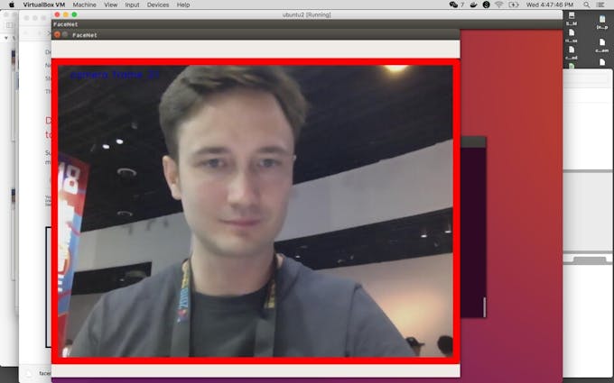

# the same face will return 0.0
# different faces return higher numbers
# this is NOT between 0.0 and 1.0
FACE_MATCH_THRESHOLD = 1.0

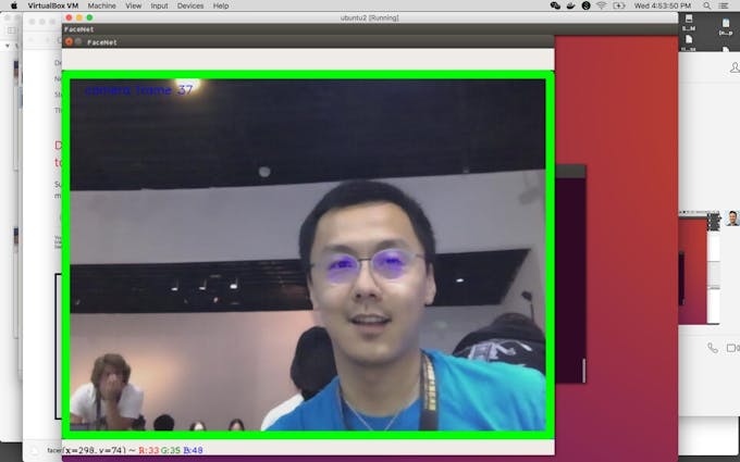

   if (matching):
       framecount += 1
           # match, green rectangle
       cv2.rectangle(display_image, (0+offset, 0+offset),
                     (display_image.shape[1]-offset-1, display_image.shape[0]-offset-1),
                     (0, 255, 0), 10)
       if framecount >= 20:
           url = "http://192.168.21.210"
           foobar ="ON"
           try:
               requests.post(url, data="ON")
           except:
               print('success')
           framecount=0
   else:
       # not a match, red rectangle
       framecount = 0
                     (0, 0, 255), 10)
