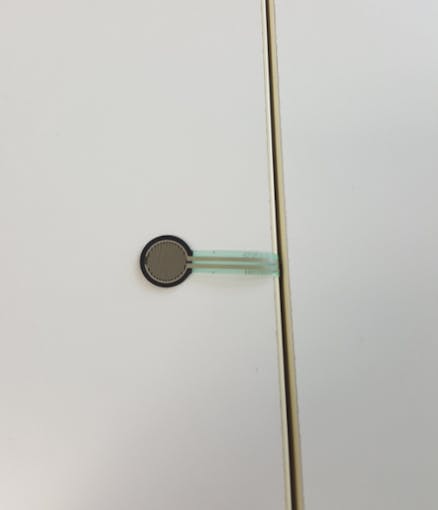

SparkFun Force sensor
×1

2. Connect Force sensor and relay to Arduino as bellow image
