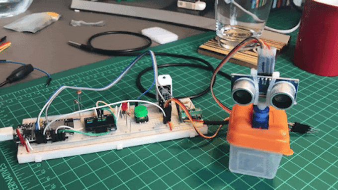

MicroPython on ESP Using Jupyter
Let's play with MicroPython on an ESP using Jupyter Notebook. Getting data from sensors and taking action in a physical world.
EasyFull instructions provided6 hours1,075
Things used in this project
NodeMCU ESP8266 Breakout Board
×1
DS18B20 Programmable Resolution 1-Wire Digital Thermometer
Maxim Integrated DS18B20 Programmable Resolution 1-Wire Digital Thermometer
×1
DHT22 Temperature Sensor
×1
Grove - OLED Display 1.12'' V2
Seeed Grove - OLED Display 1.12'' V2
×1
Servo (generic)
×1
Jupyter Notebook
Jupyter Notebook
MicroPython
Read more
Schematics
Electrical Diagram
