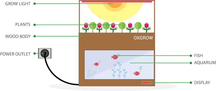

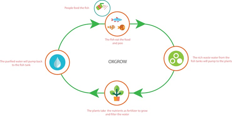

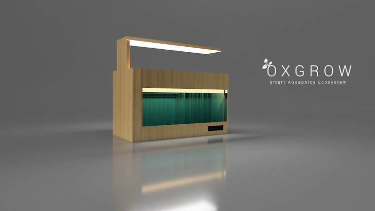

OXGROW: Smart Aquaponics System
It's an integrated cultivation of fish and plants. Co-operating a living ecosystem to help each other to grow based on NXP Rapid IoT.

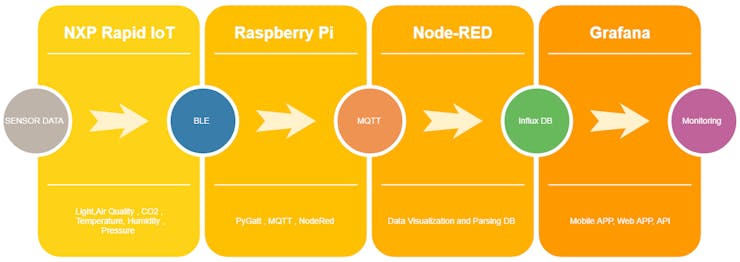

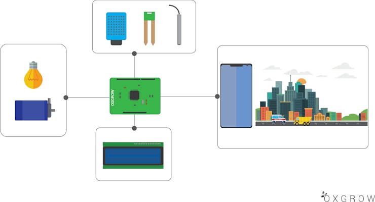

Schematics
Architecture
data flow diagram
Untitled diagram qft1zdoseb

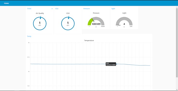

BLEtoMQTT.py
Python
Python script that will receve BLE data from NXP and send them to cloud via MQTT
import time
import pygatt
import paho.mqtt.publish as publish
from time import sleep
RPK_ADDRESS = "MAC ID"
MQTT_SERVER = "localhost"
CHAR_UUIDS = {
    "ambient-light" : "2262d1c7-5e0f-447d-bccf-6455c7a901bf",
    "pressure" : "2262d1c7-5e0f-447d-bccf-6455c7a901c2",
    "tvoc" : "2262d1c7-5e0f-447d-bccf-6455c7a901c1",
    "co2" : "2262d1c7-5e0f-447d-bccf-6455c7a901c0",
    "temperature" : "2262d1c7-5e0f-447d-bccf-6455c7a901c3",
    "humidity" : "2262d1c7-5e0f-447d-bccf-6455c7a901c4"
adapter = pygatt.GATTToolBackend()
def readData():
    try:
        # Connect to the RPK device
        adapter.start()
        conn = adapter.connect(RPK_ADDRESS)
        time_info = int(time.time()*1000000000.0)
        # Get sensor values
        sensor_values = {}
        for sensor in CHAR_UUIDS:
            value = conn.char_read(CHAR_UUIDS[sensor])
            sensor_values[sensor] = float(value.decode("utf-8").rstrip('\x00'))
        light = sensor_values["ambient-light"]
        pressure = sensor_values["pressure"]
        tvoc = sensor_values["tvoc"]
        co2 = sensor_values["co2"]
        temperature = sensor_values["temperature"]
        humidity = sensor_values["humidity"]
    #Print Sensor data
        print(light)
        print(pressure)
        print(tvoc)
        print(co2)
        print(temperature)
        print(humidity)
    #Publish Sensor data
        publish.single("light",light, hostname=MQTT_SERVER)
        publish.single("pressure",pressure, hostname=MQTT_SERVER)
        publish.single("tvoc", tvoc , hostname=MQTT_SERVER)
        publish.single("co2", co2 , hostname=MQTT_SERVER)
        publish.single("temperature", temperature, hostname=MQTT_SERVER)
        publish.single("humidity", humidity, hostname=MQTT_SERVER)
    except Exception as e:
        print ("Error: ", e)
    finally:
        adapter.stop()
while True: # Run forever
 readData()
 sleep(10)

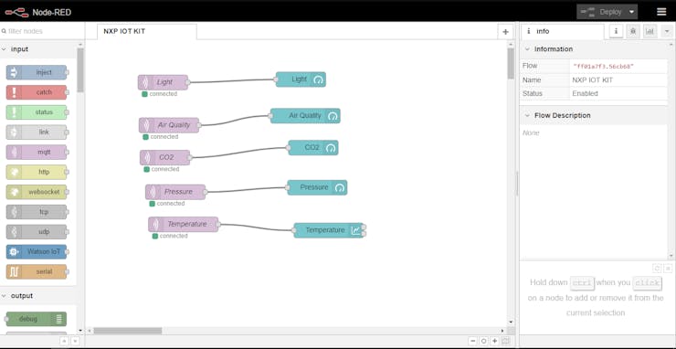

nodred_flow.json
JSON
[{"id":"ff01a7f3.56cb68","type":"tab","label":"NXP IOT KIT","disabled":false,"info":""},{"id":"d308322d.3289b","type":"mqtt in","z":"ff01a7f3.56cb68","name":"Light","topic":"light","qos":"2","broker":"5b093380.b880ac","x":156,"y":86,"wires":[["6ecef283.37b88c"]]},{"id":"6ecef283.37b88c","type":"ui_gauge","z":"ff01a7f3.56cb68","name":"Light","group":"e7514166.5fc65","order":6,"width":0,"height":0,"gtype":"gage","title":"Light","label":"lux","format":"{{value}}","min":0,"max":"2500","colors":["#00b500","#e6e600","#ca3838"],"seg1":"","seg2":"","x":433,"y":80,"wires":[]},{"id":"fc213c5f.44924","type":"mqtt in","z":"ff01a7f3.56cb68","name":"Air Quality","topic":"tvoc","qos":"2","broker":"5b093380.b880ac","x":168,"y":172,"wires":[["c5da88b2.54ba88"]]},{"id":"c5da88b2.54ba88","type":"ui_gauge","z":"ff01a7f3.56cb68","name":"Air Quality","group":"dbac2967.6a21f8","order":1,"width":0,"height":0,"gtype":"compass","title":"Air Quality","label":"ppm","format":"{{value}}","min":0,"max":"50","colors":["#00b500","#e6e600","#ca3838"],"seg1":"","seg2":"","x":442,"y":153,"wires":[]},{"id":"8991d818.804378","type":"mqtt in","z":"ff01a7f3.56cb68","name":"CO2","topic":"co2","qos":"2","broker":"5b093380.b880ac","x":160,"y":237,"wires":[["8ae81fea.31bbf"]]},{"id":"34a44d4e.5320f2","type":"mqtt in","z":"ff01a7f3.56cb68","name":"Pressure","topic":"pressure","qos":"2","broker":"5b093380.b880ac","x":181,"y":306,"wires":[["8283b692.7a15e8"]]},{"id":"c5b9faf1.52a868","type":"mqtt in","z":"ff01a7f3.56cb68","name":"Temperature","topic":"temperature","qos":"2","broker":"5b093380.b880ac","x":197,"y":371,"wires":[["ad51ae16.1fb2b"]]},{"id":"ad51ae16.1fb2b","type":"ui_chart","z":"ff01a7f3.56cb68","name":"Temperature","group":"685cbe20.4604","order":4,"width":0,"height":0,"label":"Temperature","chartType":"line","legend":"false","xformat":"HH:mm","interpolate":"linear","nodata":"","dot":true,"ymin":"0","ymax":"50","removeOlder":"1","removeOlderPoints":"","removeOlderUnit":"86400","cutout":0,"useOneColor":false,"colors":["#1f77b4","#aec7e8","#ff7f0e","#2ca02c","#98df8a","#d62728","#ff9896","#9467bd","#c5b0d5"],"useOldStyle":false,"x":489,"y":383,"wires":[[],[]]},{"id":"8ae81fea.31bbf","type":"ui_gauge","z":"ff01a7f3.56cb68","name":"CO2","group":"98bd2aec.a0c098","order":3,"width":0,"height":0,"gtype":"compass","title":"CO2","label":"ppm","format":"{{value}}","min":0,"max":"50","colors":["#00b500","#e6e600","#ca3838"],"seg1":"","seg2":"","x":458,"y":217,"wires":[]},{"id":"8283b692.7a15e8","type":"ui_gauge","z":"ff01a7f3.56cb68","name":"","group":"66e460be.93b9d","order":5,"width":0,"height":0,"gtype":"gage","title":"Pressure","label":"pa","format":"{{value}}","min":0,"max":"300000","colors":["#00b500","#e6e600","#ca3838"],"seg1":"","seg2":"","x":466,"y":297,"wires":[]},{"id":"5b093380.b880ac","type":"mqtt-broker","z":"","name":"Local","broker":"localhost","port":"1883","clientid":"","usetls":false,"compatmode":true,"keepalive":"60","cleansession":true,"birthTopic":"","birthQos":"0","birthPayload":"","closeTopic":"","closeQos":"0","closePayload":"","willTopic":"","willQos":"0","willPayload":""},{"id":"e7514166.5fc65","type":"ui_group","z":"","name":"light","tab":"ff785306.eaaf","order":4,"disp":true,"width":"6","collapse":false},{"id":"dbac2967.6a21f8","type":"ui_group","z":"","name":"TVOC","tab":"ff785306.eaaf","order":1,"disp":true,"width":"6","collapse":true},{"id":"685cbe20.4604","type":"ui_group","z":"","name":"Temp","tab":"ff785306.eaaf","order":5,"disp":true,"width":"27","collapse":false},{"id":"98bd2aec.a0c098","type":"ui_group","z":"","name":"CO2","tab":"ff785306.eaaf","order":2,"disp":true,"width":"6","collapse":false},{"id":"66e460be.93b9d","type":"ui_group","z":"","name":"Pressure","tab":"ff785306.eaaf","order":3,"disp":true,"width":"6","collapse":false},{"id":"ff785306.eaaf","type":"ui_tab","z":"","name":"Home","icon":"dashboard","disabled":false,"hidden":false}]
