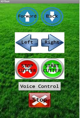

Grass Cutter Robot
An Internet-controlled robot that can cut the grass of a garden area with ease and efficiently.

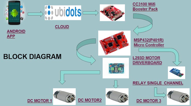

Things used in this project
MSP-EXP432P401R SimpleLink MSP432 LaunchPad
Texas Instruments MSP-EXP432P401R SimpleLink MSP432 LaunchPad
×1
CC3100BOOST SimpleLink CC3100 Wi-Fi BoosterPack
Texas Instruments CC3100BOOST SimpleLink CC3100 Wi-Fi BoosterPack
×1
Dual H-Bridge motor drivers L293D
Texas Instruments Dual H-Bridge motor drivers L293D
×1
Grove - 2-Channel SPDT Relay
Seeed Grove - 2-Channel SPDT Relay
×1
Energia
Texas Instruments Energia
MIT App Inventor
MIT App Inventor
Ubidots
Ubidots

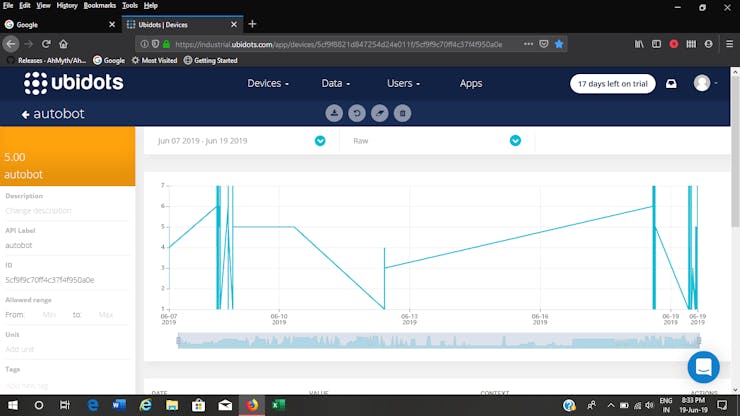

char * server = "industrial.api.ubidots.com";
char* TOKEN = "BBFF-rSICR8dcv40GP01Nl1iklcEVcN7tNj"; // Put here your TOKEN
char* DEVICE_LABEL = "autobot"; // Your Device label
/* Put here your variable's labels*/
char const * VARIABLE_LABEL = "autobot";

void loop() {
   if (client.connect(server, 80)) {
    client.print(F("GET /api/v1.6/devices/"));
    client.print(DEVICE_LABEL);
    client.print(F("/"));
    client.print(VARIABLE_LABEL);
    client.print(F("/lv"));
    client.print(F(" HTTP/1.1\r\n"));
    client.print(F("Host: "));
    client.print(server);
    client.print(F("\r\n"));
    client.print(F("User-Agent: "));
    client.print(USER_AGENT);
    client.print(VERSION);
    client.print(F("X-Auth-Token: "));
    client.print(TOKEN);
    client.print(F("Content-Type: application/json\r\n\r\n"));
    client.println();

  if(movement=='1'){    //Forward
  digitalWrite(LeftMotor1, HIGH);
  digitalWrite(LeftMotor2, LOW);
  digitalWrite(RightMotor1, HIGH);
  digitalWrite(RightMotor2, LOW);
  else if(movement=='2'){ //Backward
  digitalWrite(LeftMotor2, HIGH);
  digitalWrite(LeftMotor1, LOW);
  digitalWrite(RightMotor2, HIGH);
  digitalWrite(RightMotor1, LOW);
  else if(movement=='3'){ //left
  else if(movement=='4'){ //Right
  else if(movement=='5'){ //stop
   else if(movement=='6')
  digitalWrite(CUTTER , HIGH);
    else if(movement=='7')
    digitalWrite(CUTTER , LOW);
