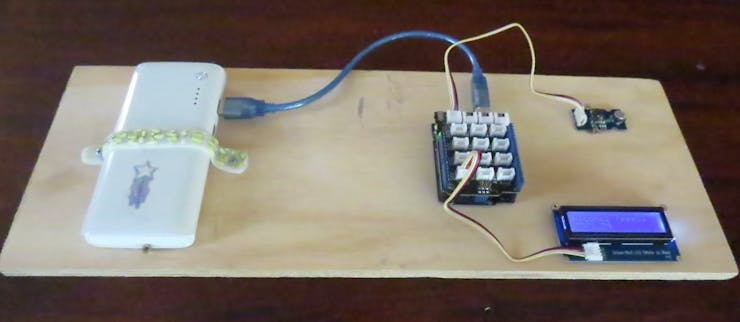

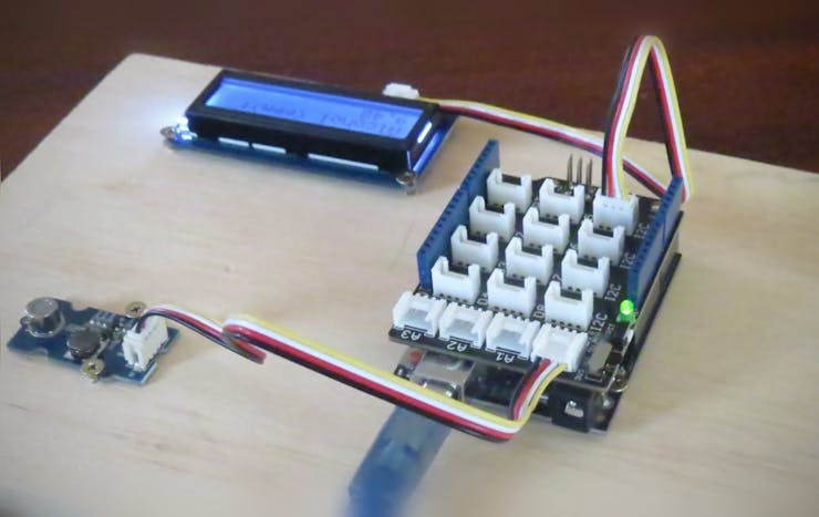

Things used in this project
Seeed Grove Alcohol Sensor
×1
Seeed Grove Base Shield v2
×1
Seeed Grove 16x2 LCD (White on Blue)
×1
Arduino UNO & Genuino UNO
×1

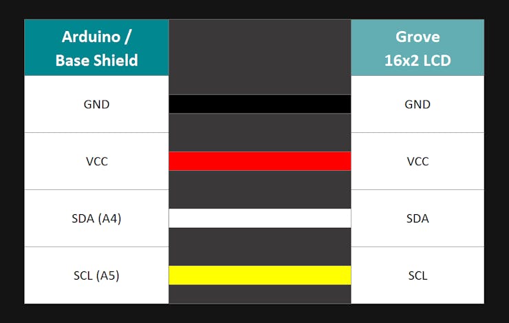

Connections
Alcohol project board2 yc6mawdfcz
