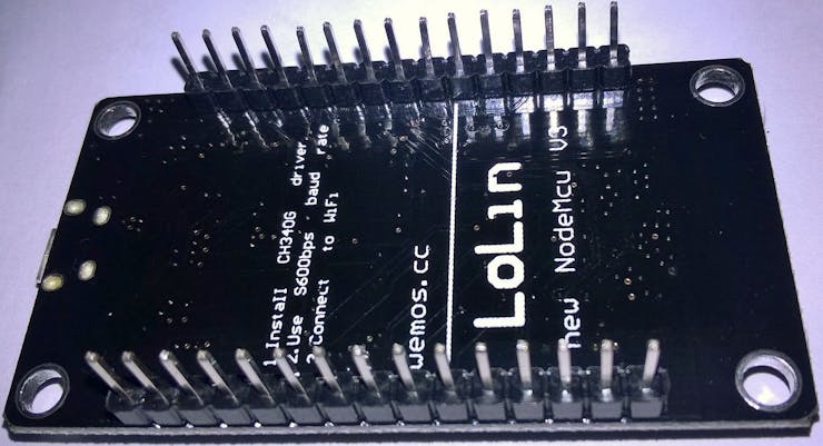

Getting started with ESP NodeMcu using ArduinoIDE
A step-by-step tutorial about setting up of this ESP module and executing the "Blinking-LED" code in ArduinoIDE.

NodeMCU ESP8266 Breakout Board

Schematics
Connection schematic diagram
Follow the tutorial for connecting the NodeMCU module
Blink bb
