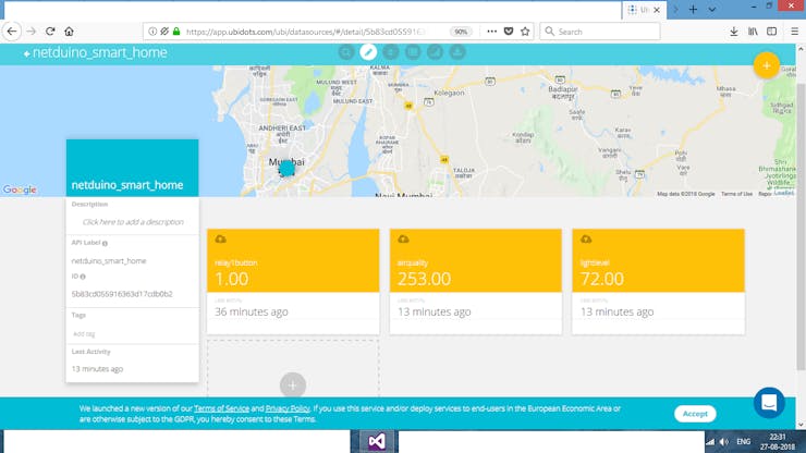

Smart Home Using Netduino
Control your appliances from anywhere in the world! Monitor your room temperature, humidity, light intensity and air quality from smartphone
IntermediateFull instructions provided2 days1,566

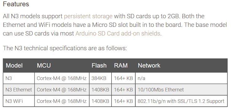

Netduino3 WiFi
Wilderness Labs (Netduino) Netduino3 WiFi
×1

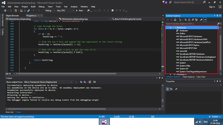

Visual Studio 2015
Microsoft Visual Studio 2015

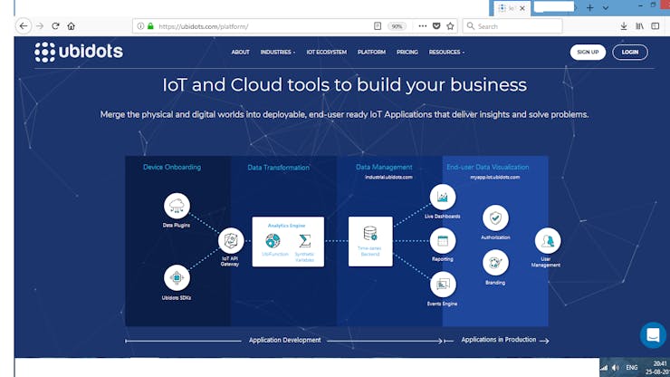

Ubidots
Ubidots

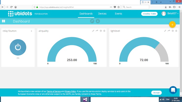

Ubidots Uploading and Receiving Program
C#
Program to receive the data using http get request and also uploading the data to ubidots using http post request

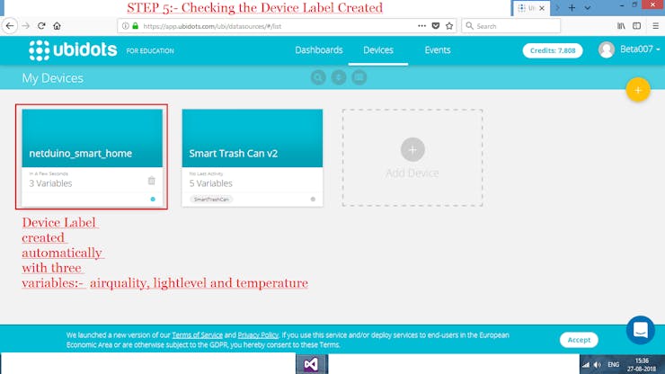

                string deviceLabel = "netduino_smart_home";
                string ubidotsURL = "http://things.ubidots.com/api/v1.6/devices/";
                ubidotsURL = ubidotsURL + deviceLabel + "/";
                app.MakeWebRequest(ubidotsURL);

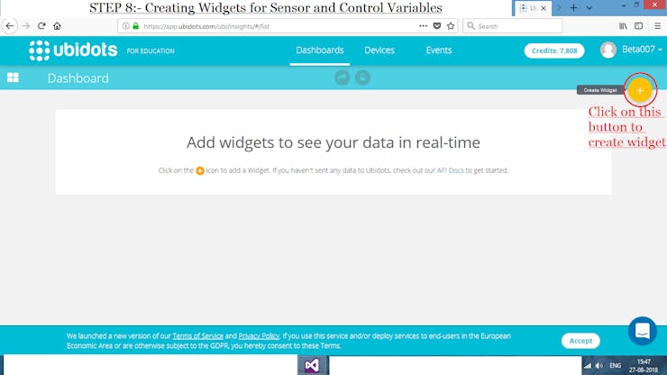

                string controlVariable1 = "relay1button";
                int dataReceived = app.ReceiveWebRequest(ubidotsURL, controlVariable1);
                Debug.Print("");
                Debug.Print("Data Received:- " + dataReceived);
                if (dataReceived == 1)
                    Debug.Print("Turning the Relay1 ON Connected to Pin D2");
                else if (dataReceived == 0)
                    Debug.Print("Turning the Relay1 OFF Connected to Pin D2");
                Thread.Sleep(2500);

Netduino On-board LED Control using Ubidots IoT Platform
C#
Controlling the LED present on the Netduino board from Ubidots IoT Platform website dashboard or from it's Smartphone Application.

Relay Control using Netduino and Ubidots
C#
Controlling a relay connected to a digital pin of Netduino via Ubidots website or App.

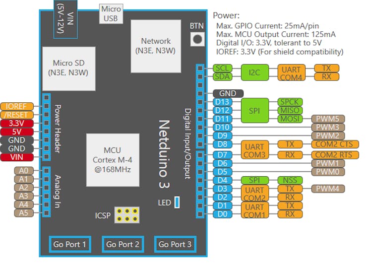

            OutputPort led = new OutputPort(Pins.ONBOARD_LED, false);
            OutputPort relay1 = new OutputPort(Pins.GPIO_PIN_D2, false);
            relay1.Write(false); // turn off the relay
            var ldrSensor = new SecretLabs.NETMF.Hardware.AnalogInput(Pins.GPIO_PIN_A0);
            var airQualitySensor = new SecretLabs.NETMF.Hardware.AnalogInput(Pins.GPIO_PIN_A1);

                string sensor1Label = "lightLevel";
                int sensor1Data = ldrPercent;
                string sensor2Label = "airQuality";
                int sensor2Data = airQualityValue;
                app.UploadWebRequest(ubidotsURL, sensor1Label, sensor1Data, sensor2Label, sensor2Data);
                Debug.Print("");
                    relay1.Write(true); // turn on the relay
