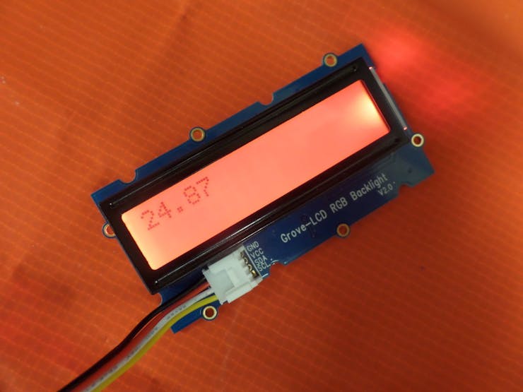

COI - Temperature Monitor
You will need an Intel Edison for Arduino, a Grove Starter Kit Plus and a computer with the Edison-Arduino IDE installed.
Full instructions provided422
