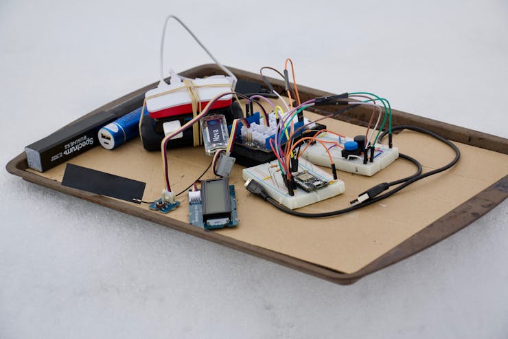

Fire Equipment Management
Firefighters must manage their equipment out in the field. Paper gets lost, and WIFI is rare. Simply transmit tracking info via cellular.
IntermediateFull instructions provided10 hours501

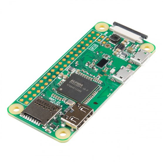

Raspberry Pi Zero Wireless

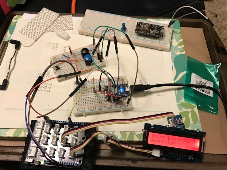

Particle Photon Inventory Controller
This is the device that allows users to select inventory items and quantity and alter the inventory total

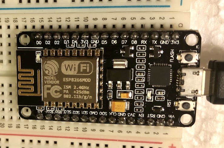

Wifi Access Point - ESP8266MOD
C/C++
This is the wireless access point that allows the particle photon to connect to the Raspberry Pi Zero W.
This code goes in the Arduino IDE and gets flashed onto the ESP8266.
Of course, you'll need to use your own SSID and Password.
