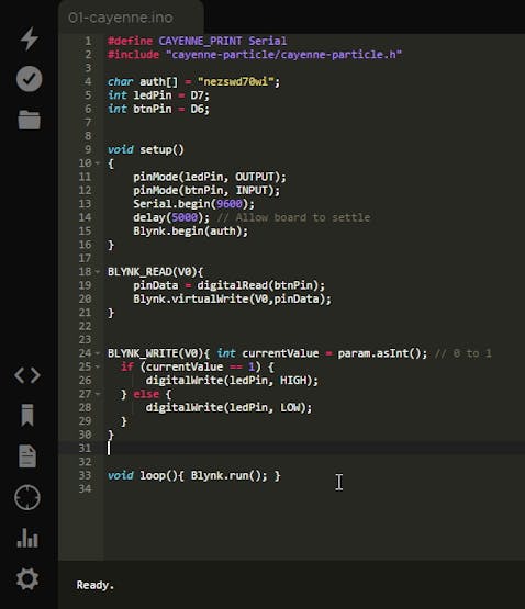

Code on Particle Photon
#define CAYENNE_PRINT Serial
#include "cayenne-particle/cayenne-particle.h"
char auth[] = "nezswd70wi";
int ledPin = D7;
int btnPin = D6;
void setup()
    pinMode(ledPin, OUTPUT);
    pinMode(btnPin, INPUT);
    Serial.begin(9600);
    delay(5000); // Allow board to settle
    Blynk.begin(auth);
BLYNK_READ(V0){
    pinData = digitalRead(btnPin);
    Blynk.virtualWrite(V0,pinData);
BLYNK_WRITE(V0){ int currentValue = param.asInt(); // 0 to 1
  if (currentValue == 1) {
      digitalWrite(ledPin, HIGH);
  } else {
      digitalWrite(ledPin, LOW);
void loop(){ Blynk.run(); }

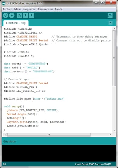

Code for LinkIt ONE
#include <LWiFi.h>
#include <LWiFiClient.h>
#define CAYENNE_DEBUG         // Uncomment to show debug messages
#define CAYENNE_PRINT Serial  // Comment this out to disable prints and save space
#include <CayenneLWiFiWpa.h>
#include <LSD.h>
#include <LAudio.h>
char token[] = "2fm04460o2";
char ssid[] = "MOVLAU";
char password[] = "l4ur3nc3.w1";
// Custom Widget
#define VIRTUAL_PIN 1
#define LED_DIGITAL_PIN 12
#define file_name (char *)"iphone.mp3"
void setup(){
  pinMode(LED_DIGITAL_PIN, OUTPUT);
  Serial.begin(9600);
  LSD.begin();
  Cayenne.begin(token, ssid, password);
  LAudio.setVolume(5);
CAYENNE_IN(VIRTUAL_PIN){
  int currentValue = getValue.asInt(); // 0 to 1
    digitalWrite(LED_DIGITAL_PIN, HIGH);
    Serial.print("Playing: ");
    Serial.println(file_name);
    LAudio.playFile(storageSD,file_name);
    delay(3000);
    delay(3000);
    LAudio.stop();
    digitalWrite(LED_DIGITAL_PIN, LOW);
    Cayenne.virtualWrite(1,LOW);
  } else {
    LAudio.stop();
void loop(){Cayenne.run();}
