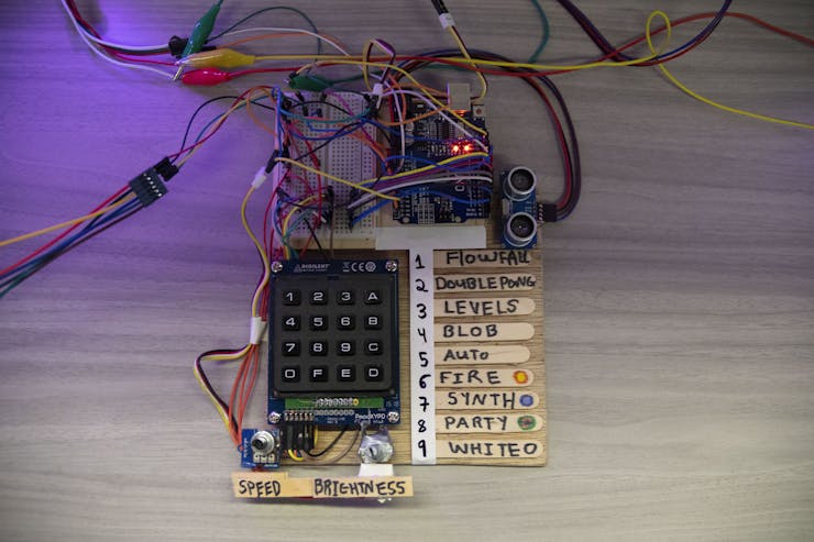

Translightion Board (Controllable Music Visualizer)
Translate music to a dazzling light show with this customizable light controller project. Great for DJs, parties, and 1:1 shows!
BeginnerFull instructions provided1 hour3,240
Things used in this project
Arduino UNO & Genuino UNO
×1
Ultrasonic Sensor - HC-SR04 (Generic)
×1
Pmod KYPD
Digilent Pmod KYPD
×1
Rotary potentiometer (generic)
×2
WS2812 Addressable LED Strip
Digilent WS2812 Addressable LED Strip
×2
Seeed Grove Sound Sensor v1.6
×1

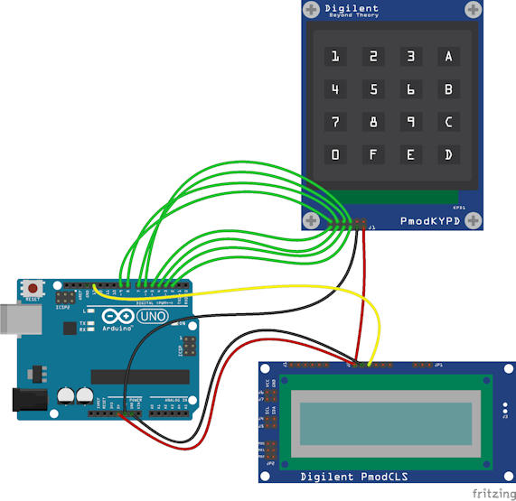

const byte LINE = 4; // 4 lines
const byte COLUMN = 4; // 4 columms
//Declaration of the key of the keypad
char hexaKeys[LINE][COLUMN] =
  {'1', '2', '3', 'A'},
  {'4', '5', '6', 'B'},
  {'7', '8', '9', 'C'},
  {'0', 'F', 'E', 'D'}
//Assignement of pin for the keypad
byte line_pin[LINE] = {2, 3, 4, 5};
byte column_pin[COLUMN] = {6, 7, 8, 9};
Keypad clavier = Keypad( makeKeymap(hexaKeys), line_pin, column_pin, LINE, COLUMN); // creation of object keypad
