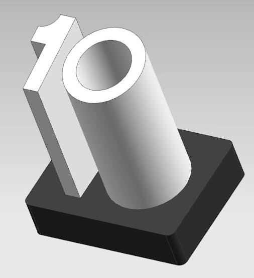

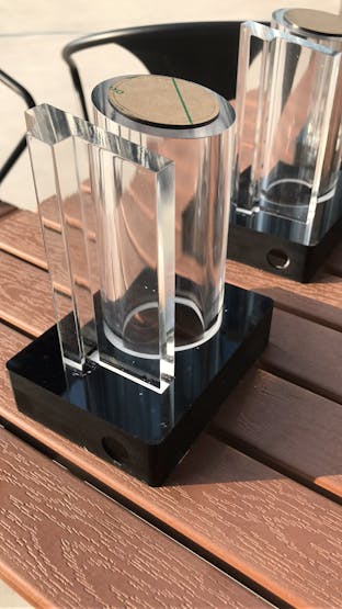

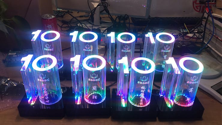

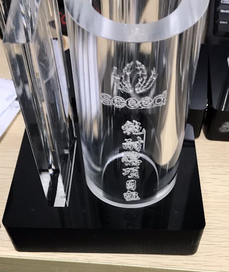

A Trophy That Blinks
The trophy is customized to reward the outstanding employees and teams with the shape of 10 to celebrate the 10th anniversary of Seeed.

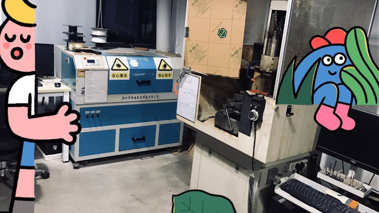

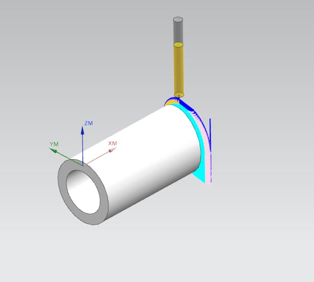

CNC Milling Machine
Laser cutter (generic)

Custom parts and enclosures
Seeed10 Trophy Laser Cutting Parts in CAD
Seeed10 Trophy Laser Cutting Parts in dxf
Seeed10 Trophy 3D Design & Milling Files

#include "grove_led_ws2812.h"
// 10 leds
GroveLedWs2812 led_ring(12);
// 20 leds
GroveLedWs2812 led_stick(13);
void setup() {
    pinMode(PIN_GROVE_POWER, OUTPUT);
    digitalWrite(PIN_GROVE_POWER, 1);
    led_ring.write_start_rainbow_flow(20, 100, 5);
    led_stick.write_start_rainbow_flow(10, 100, 5);
