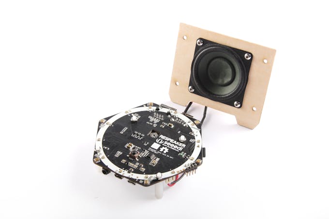

ReSpeaker Voice Reception System
The system includes a ReSpeaker Core v2.0 and speaker. Visitor can talk with it and it will drop a message to the person to be visited.
IntermediateFull instructions provided8 hours1,744
Things used in this project
ReSpeaker Core v2.0
Seeed ReSpeaker Core v2.0
×1
Speaker: 0.25W, 8 ohms
×1

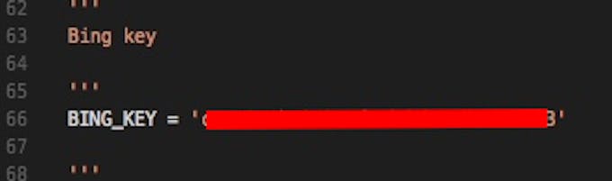

Bing key
BING_KEY = ''

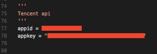

tencent key
appid = ''
appkey = ''

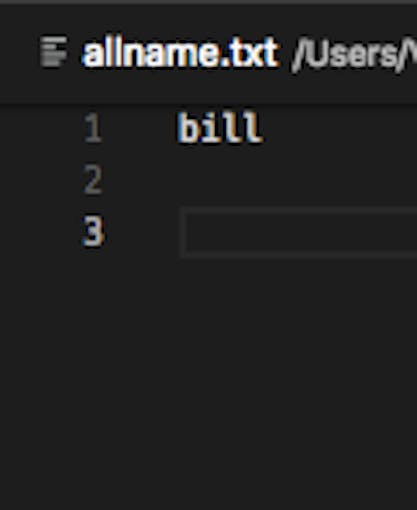

			if you want to add new names into username_en.txt and allname.txt,
			please run the python and check the print out texts,
			then add the related texts into username_en.txt and allname.txt.
			for example, if you say "seth", the bing may recoginze as seth, sis, set.
			please add all of them into username_en.txt and allname.txt.
