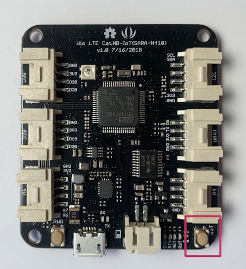

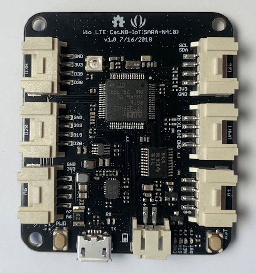

Schematics
NB-IoT board setup
Breakout antenna gw1z1p4w9r

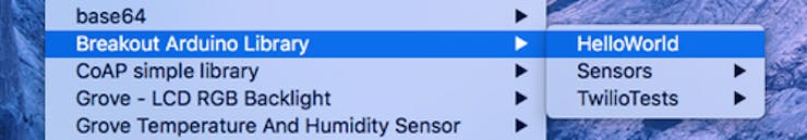

Code
HelloWorld.ino
Arduino
This is the modified version of the Breakout SDK HelloWorld.ino file.

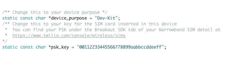

static const char *device_purpose = "Dev-Kit";
static const char *psk_key = "YOUR_PSK";

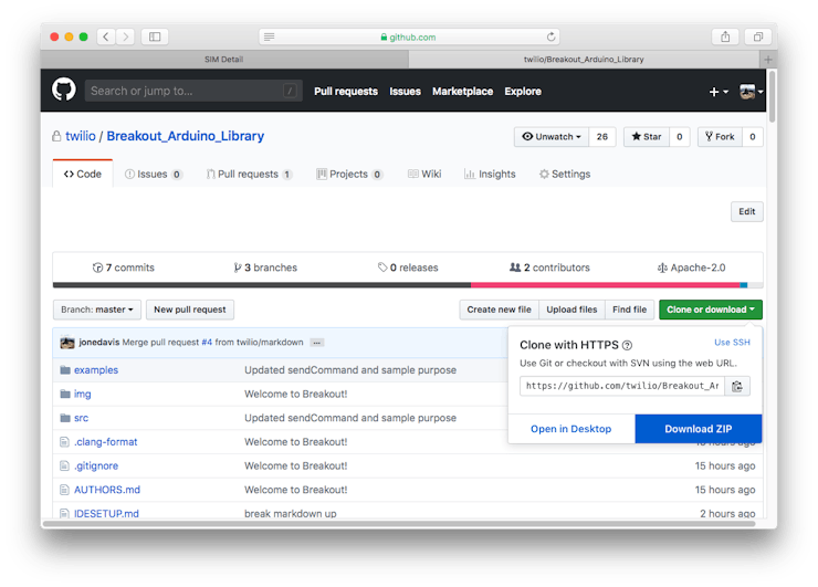

Github
https://github.com/twilio/Breakout_Arduino_Library
Github
https://github.com/cskonopka/TwilioIoT
