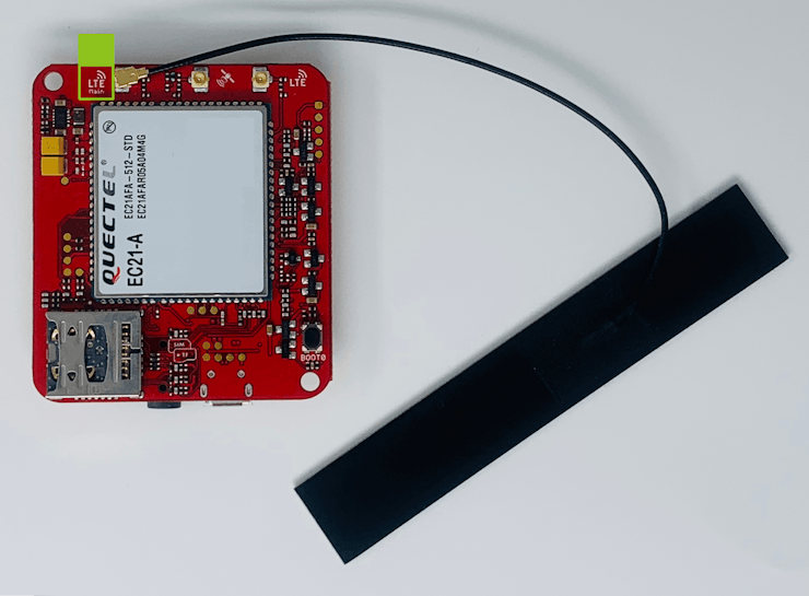

Wio LTE US Version - 4G, Cat.1, GNSS, JavaScript(Espruino) Compatible
Seeed Wio LTE US Version - 4G, Cat.1, GNSS, JavaScript(Espruino) Compatible
×1
LTE Antenna
×1
3.7v Lithium Ion Battery
×1

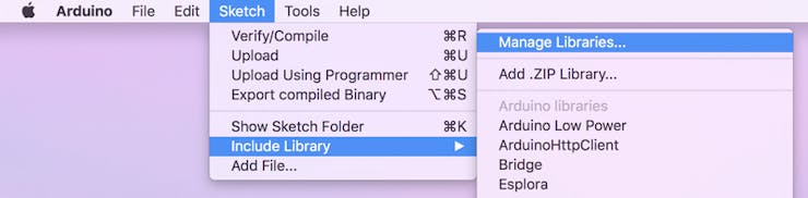

Seeed Studio Wio LTE Arduino Library
Read more

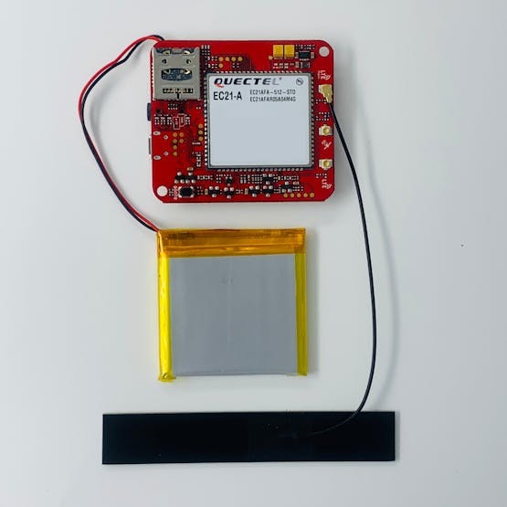

Wio LTE hardware setup
M2m wiolte allconnected 6jnwnfuhcv

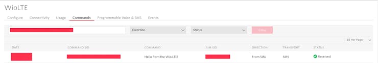

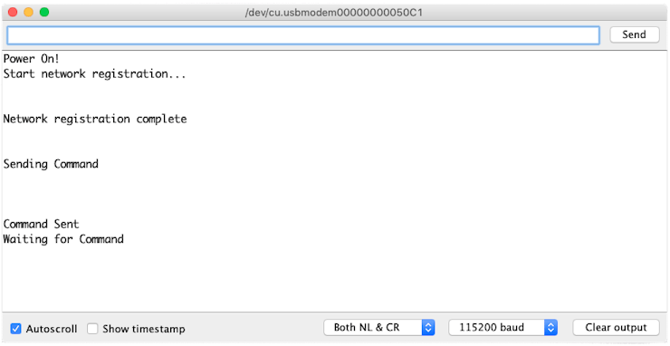

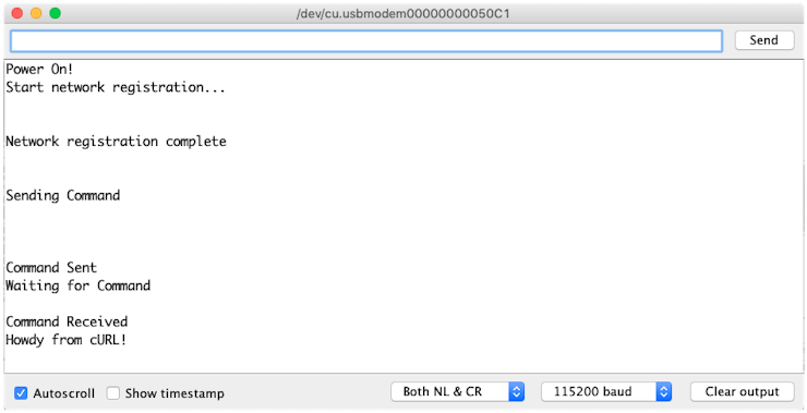

  SerialUSB.println("Sending Command");
  char message[128] = "Hello from the Wio LTE!";
    Send an SMS to short code 2936, which is a Twilio
    Machine-to-Machine command.
    Write a Twilio M2M command.
  if (wio.sendSMS("2936", message))
    SerialUSB.println("Command Sent");
  else
    SerialUSB.println("Send Error");

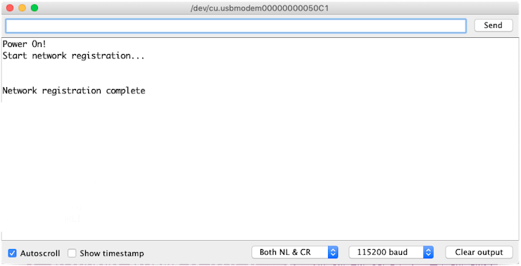

  SerialUSB.println("Waiting for Command");
void loop() {
    Detect unread Commands
  int id = wio.detectRecUnreadSMS();
    Define the index of the incoming Commands
  if (-1 != id) {
    newSMSNumber = id;
      Read a Twilio M2M command. Note that it will find the lowest
      indexed one with the code as is; in your code. if you cache the
      index you can start the next read_command to move to the next one.
    wio.readSMS(newSMSNumber, receivedMessage, 128);
    SerialUSB.println("Command Received");
    SerialUSB.println(receivedMessage);
  delay(1000);
