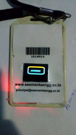

Step 2: MAKEING OF SMART IDENTITY CARD
Remove the sticker of identity card and make a cut as illustrated in pic above for battery, Attiny85 and O.LED display
you can also change it and make cut according to your own design and concept.

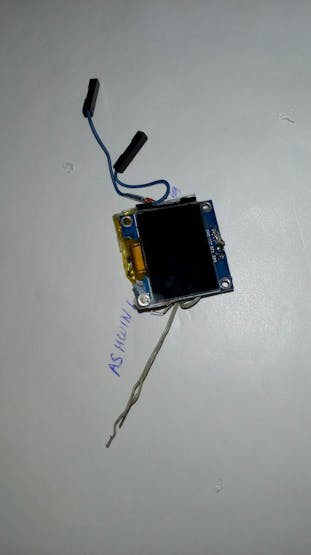

Now solder the wires as described below:-
DIGISPARK ATTINY85 ---------------------SSD1306 O.LED Display
Pin0----------------------------------------------->SDA Pin
pin2----------------------------------------------->SCL Pin
5V------------------------------------------------->VCC
GND---------------------------------------------->GND
solder the wires according to above connections and as illustrated in pic above
Now open the Arduino IDE and upload the code below to DIGISPARK or you can Downlode the code from Link below
To Know more about how to upload the code to Digispark you can take the help of google.
Now after uploading the code fix all the things with hot glue and duct tape and battery as illustrated in pics above..
Congratulations you have done Have fun with it amaze your friends wit such a unique Identity card

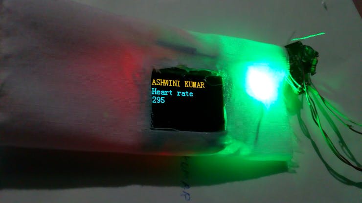

Step 4: MAKING OF SMART WEARABLE SHIRT THAT SHOW LIVE HEARTBEAT DATA
Make the connections between OLED and DIGISPARK ATTINY85 as below
DIGISPARK ATTINY85 ---------------------SSD1306 O.LED DisplayPin0----------------------------------------------->SDA Pin
Connect LED and HEARTBEAT Sensor as below
LED---------------------------------------------------DIGISPARK PIN 4
HEART SENSOR OUT ------------------------>DIGISPARK PIN 1
HEART SENSOR VCC------------------------->DIGISPARK 5v PIN
HEART SENSOR GND------------------------->DIGISPARK GND
NOTE :-must use original HEARTBEAT sensor available online for accurate reading and making things work, as I don't have that sensor so I have make my own from a photo diode that do not show correct reading, So must use HEART SENSOR available online store like on amazon, ebay etc

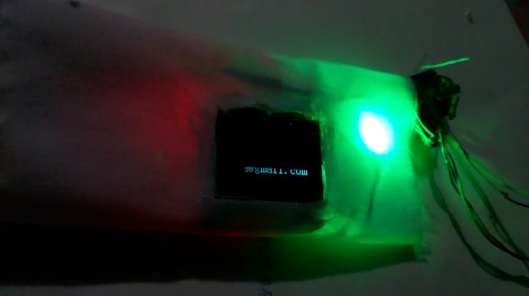

Now uplode the below code from Arduino IDE.
#include #include
int senval=0;
void setup()
oled.begin();
void loop() {
senval=analogRead(1);
analogWrite(4, senval-600);//change it according to your sensor type
oled.clear();
oled.setCursor(0, 0);
oled.setFont(FONT8X16);
oled.print("your text"); //your text here
oled.setCursor(0, 2);
oled.println("Heart rate");
oled.print(senval-600);//change it according to sensor
delay(2000);
oled.clear();
oled.setCursor(0, 0); //top left
oled.print("ASHWINI KUMAR");
oled.print("pulse rate");
oled.setCursor(0, 4);
oled.print(senval);
oled.setCursor(0, 6);
oled.print("yourtext@gmail.com");//your text here
delay(2000); }

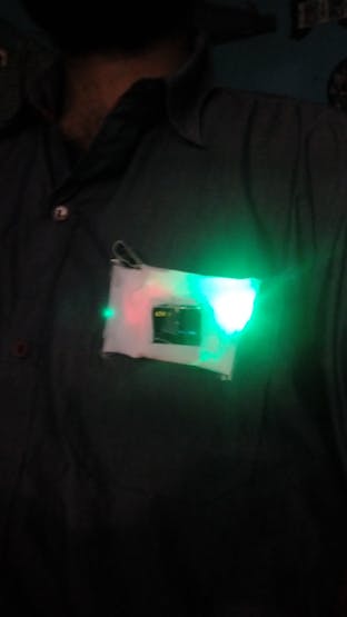

After uploading the code fix all the things together with Hot Glue as illustrated in pics above then sew it to your shit as illustrated in pic above.
