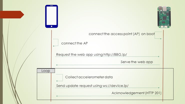

The control of a robot may be painful as you have to develop specific clients for each mobile device. I propose a Web based control

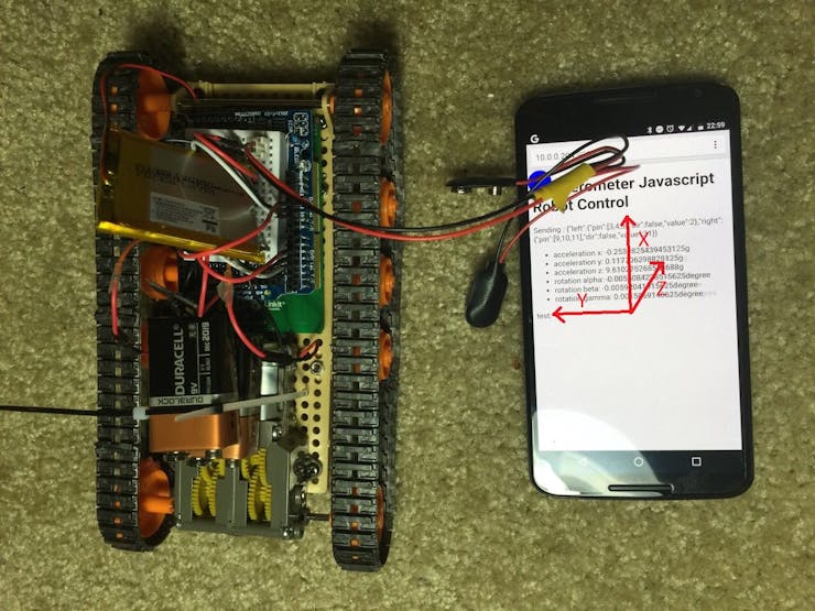

Robot
Hardware configuration - Using BeagleBone Black instead of BeagleBone Green as the green is not Available on the tool
Picture of the configuration
Use BeagleBone Green instead of BeagleBone Black
