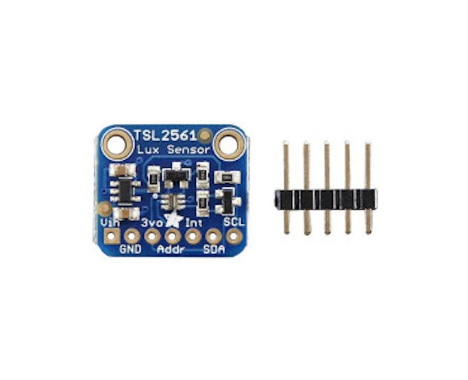

Lux Sensor TSL2561
C/C++
TSL2561.cpp
 * mbed library program
 *  Luminosity sensor -- LIGHT-TO-DIGITAL CONVERTER (light intensity to a digital signal output)
 *  TSL2561 by Texas Advanced Optoelectronic Solutions Inc.
 * Copyright (c) 2015,'17 Kenji Arai / JH1PJL
 *  http://www.page.sannet.ne.jp/kenjia/index.html
 *  http://mbed.org/users/kenjiArai/
 *      Created: Feburary   21st, 2015
 *      Revised: August     23rd, 2017
#include "TSL2561.h"
TSL2561::TSL2561 (PinName p_sda, PinName p_scl)
 : _i2c_p(new I2C(p_sda, p_scl)), _i2c(*_i2c_p)
    TSL2561_addr = TSL2561_ADDRESS_GND;
    init();
TSL2561::TSL2561 (PinName p_sda, PinName p_scl, uint8_t addr)
    TSL2561_addr = addr;
    init();
TSL2561::TSL2561 (I2C& p_i2c)
 : _i2c(p_i2c)
    init();
TSL2561::TSL2561 (I2C& p_i2c, uint8_t addr)
 : _i2c(p_i2c)
    init();
/////////////// Read Lux from sensor //////////////////////
For 0    < CH1/CH0 < 0.50 Lux = 0.0304  x CH0-0.062  x CH0 x ((CH1/CH0)1.4)
For 0.50 < CH1/CH0 < 0.61 Lux = 0.0224  x CH0-0.031  x CH1
For 0.61 < CH1/CH0 < 0.80 Lux = 0.0128  x CH0-0.0153 x CH1
For 0.80 < CH1/CH0 < 1.30 Lux = 0.00146 x CH0-0.00112x CH1
For        CH1/CH0 > 1.30 Lux = 0
float TSL2561::lux()
    double lux0, lux1;
    double ratio;
    double dlux;
    dt[0] = CMD_MULTI + TSL2561_DATA0LOW;
    _i2c.write((int)TSL2561_addr, (char *)dt, 1, true);
    _i2c.read(TSL2561_addr, (char *)dt, 2, false);
    ch0 = dt[1] << 8 | dt[0];
    dt[0] = CMD_MULTI + TSL2561_DATA1LOW;
    ch1 = dt[1] << 8 | dt[0];
    if (ch0 == 0xFFFF) {
        return 2500.0;
    lux0 = (double)ch0;
    lux1 = (double)ch1;
    ratio = lux1 / lux0;
    read_timing_reg();
    lux0 *= (402.0/integ_time);
    lux1 *= (402.0/integ_time);
    lux0 /= gain;
    lux1 /= gain;
    if (ratio <= 0.5) {
        dlux = 0.03040 * lux0 - 0.06200 * lux0 * pow(ratio,1.4);
    } else if (ratio <= 0.61) {
        dlux = 0.02240 * lux0 - 0.03100 * lux1;
    } else if (ratio <= 0.80) {
        dlux = 0.01280 * lux0 - 0.01530 * lux1;
    } else if (ratio <= 1.30) {
        dlux = 0.00146 * lux0 - 0.00112 * lux1;
    } else {
        dlux = 0;
    return (float)dlux;
/////////////// Initialize ////////////////////////////////
void TSL2561::init()
    _i2c.frequency(100000);
    power_up();
    set_timing_reg(TIMING_DEFAULT);
/////////////// Timing Register ///////////////////////////
uint8_t TSL2561::set_timing_reg(uint8_t parameter)
    dt[0] = CMD_SINGLE + TSL2561_TIMING;
    dt[1] = parameter;
    _i2c.write((int)TSL2561_addr, (char *)dt, 2, false);
    _i2c.read(TSL2561_addr, (char *)dt, 1, false);
    return dt[0];
uint8_t TSL2561::read_timing_reg(void)
    uint8_t i;
    if (dt[0] & TIMING_GAIN_16){
        gain = 16;
    } else {
        gain = 1;
    i = dt[0] & 0x3;
    switch (i) {
        case 0:
            integ_time = 13.7;
            break;
        case 1:
            integ_time = 101.0;
            break;
        case 2:
            integ_time = 402.0;
            break;
        default:
            integ_time = 0;
            break;
    return dt[0];
/////////////// ID ////////////////////////////////////////
uint16_t TSL2561::read_ID()
    dt[0] = CMD_SINGLE + TSL2561_ID;
    id_number = dt[0] << 8 | dt[1];
    return id_number;
uint8_t TSL2561::who_am_i()
    read_ID();
    if ((id_number >> 4) == I_AM_TSL2561) {
        return 1;
    } else {
        return 0;
/////////////// Power ON/OFF //////////////////////////////
void TSL2561::power_up()
    dt[0] = CMD_SINGLE + TSL2561_CONTROL;
    dt[1] = 3;
void TSL2561::power_down()
    dt[1] = 0;
/////////////// I2C Freq. /////////////////////////////////
void TSL2561::frequency(int hz)
    _i2c.frequency(hz);
Lux Sensor TSL2561
C/C++
TSL2561.h
 *---------------- REFERENCE ----------------------------------------------------------------------
 *  https://docs.google.com/viewer?url=http%3A%2F%2Fwww.adafruit.com%2Fdatasheets%2FTSL256x.pdf
 *  https://learn.adafruit.com/tsl2561?view=all
 *  http://www.adafruit.com/products/439
 *  http://akizukidenshi.com/catalog/g/gM-08219/
#ifndef TSL2561_H
#define TSL2561_H
#include "mbed.h"
// Luminosity sensor, TSL2561
// Address b7=0,b6=1,b5=1,b4=1,b3=0,b2=0,b1=1, b0=R/W
#define TSL2561_ADDRESS_GND         (0x29 << 1)
#define TSL2561_ADDRESS_FLOAT       (0x39 << 1)
#define TSL2561_ADDRESS_VDD         (0x49 << 1)
////////////// Registers //////////////////////////////////
// Register definition
#define TSL2561_CONTROL             0x00
#define TSL2561_TIMING              0x01
#define TSL2561_THRESHLOWLOW        0x02
#define TSL2561_THRESHHIGHLOW       0x04
#define TSL2561_INTERRUPT           0x06
#define TSL2561_CRC                 0x08
#define TSL2561_ID                  0x0A
#define TSL2561_DATA0LOW            0x0C
#define TSL2561_DATA0HIGH           0x0D
#define TSL2561_DATA1LOW            0x0E
#define TSL2561_DATA1HIGH           0x0F
////////////// TIMING PARAMETER ///////////////////////////
#define TIMING_GAIN_1               (0UL << 4)
#define TIMING_GAIN_16              (1UL << 4)
#define TIMING_TIME_13R7            (0x0)
#define TIMING_TIME_101             (0x1)
#define TIMING_TIME_402             (0x2)
#define TIMING_TIME_MANU            (0x3)
#define TIMING_DEFAULT              (TIMING_GAIN_1 + TIMING_TIME_402)
////////////// ID /////////////////////////////////////////
#define I_AM_TSL2561                0x50
#define REG_NO_MASK                 0x0F
////////////// COMMAND ////////////////////////////////////
#define CMD_CMDMODE                 (1UL << 7)
#define CMD_CLEAR                   (1UL << 6)
#define CMD_WORD                    (1UL << 5)
#define CMD_BLOCK                   (1UL << 4)
#define CMD_SINGLE                  (CMD_CMDMODE)
#define CMD_MULTI                   (CMD_CMDMODE + CMD_WORD)
/** Interface for Luminosity sensor, TSL2561
 * @code
 * #include "mbed.h"
 * #include "TSL2561.h"
 * // I2C Communication
 *  TSL2561      lum(dp5,dp27);    // TSL2561 SDA, SCL
 * // If you connected I2C line not only this device but also other devices,
 * //     you need to declare following method.
 *  I2C          i2c(dp5,dp27);    // SDA, SCL
 *  TSL2561      lum(i2c);         // TSL2561 SDA, SCL (Data available every 400mSec)
 * int main() {;
 *   while(true){
 *      printf("Illuminance: %+7.2f [Lux]\r\n", lum.lux());
 *      wait(1.0);
 * @endcode
class TSL2561
public:
    /** Configure data pin
      * @param data SDA and SCL pins
    TSL2561(PinName p_sda, PinName p_scl);
    TSL2561(PinName p_sda, PinName p_scl, uint8_t addr);
    /** Configure data pin (with other devices on I2C line)
      * @param I2C previous definition
    TSL2561(I2C& p_i2c);
    TSL2561(I2C& p_i2c, uint8_t addr);
    /** Get approximates the human eye response
      *  in the commonly used Illuminance unit of Lux
      * @param none
      * @return Lux
    float lux(void);
    /** Set timing register
      * @param timing parameter
      * @return timing read data
    uint8_t set_timing_reg(uint8_t parameter);
    /** Read timing register
    uint8_t read_timing_reg(void);
    /** Set I2C clock frequency
      * @param freq.
      * @return none
    void frequency(int hz);
    /** check Device ID number
      * @param none
      * @return TSL2561 = 1, others  0
    uint8_t who_am_i(void);
    /** Read ID and Revision Number
      * @param none
      * @return ID + REVNO
    uint16_t read_ID(void);
    /** Power Up/Down
      * @param none
      * @return none
    void power_up(void);
    void power_down(void);
protected:
    I2C *_i2c_p;
    I2C &_i2c;
    void init(void);
private:
    bool TSL2561Initialised;
    uint8_t  TSL2561_addr;
    uint8_t  dt[4];
    uint32_t ch0;
    uint32_t ch1;
    int8_t   gain;
    uint8_t  id_number;
    double   integ_time;
#endif      // TSL2561_H
