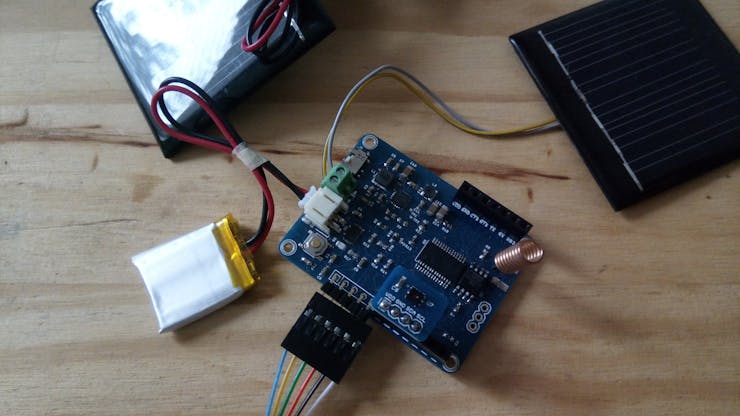

Monitor your greenhouse or personal garden environmental variables at a glance with a Linkit enabled sensor Hub.

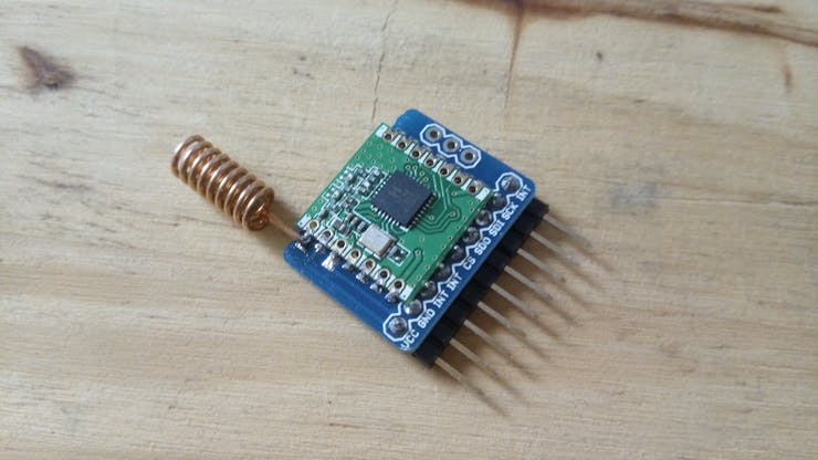

RFM69CW
Any EBAY module

Radio schematic
radio schematic and layout file used on the hub side

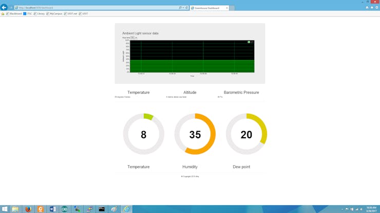

Garden sensors dashboard with Linkit DUO
