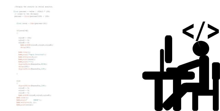

 * Sense : Smart
 * Author : Geeve George
#define ALCOHOL_DAT A0
#define HEATER_SEL  A1
#include<Wire.h>
#include "rgb_lcd.h"
rgb_lcd lcd;
int colorR = 10;
int colorG = 10;
int colorB = 10;
int BuzzerPin = 7;
void setup()
    lcd.begin(16, 2);
    lcd.setRGB(colorR, colorG, colorB);
  Serial.begin(9600);  // open the serial port at 9600 bps
  pinsInit();
  switchOnHeater();
  Serial.println("Start to heat the sensor, please wait 5~10min befor exposure to alcohol");
  pinMode(BuzzerPin,OUTPUT);
void loop()
  int sensorValue;
  sensorValue = analogRead(ALCOHOL_DAT); //read the analog value
  int value = 1023 - sensorValue;
  //Disply the results in serial monitor.
 float percent = value / 1024.0 * 100;
  // round to two decimals
  percent = floor(percent*100) / 100;
    float recal = fabs(percent-10);
    if(recal>42)
      colorR = 255;
      colorG = 0;
      colorB = 0;
        lcd.setRGB(colorR,colorG,colorB);
        delay(30);
      lcd.clear();
      lcd.print("Vapor Detected");
      lcd.setCursor(0,1);
      lcd.print(recal);
      lcd.print("%");
      digitalWrite(BuzzerPin,HIGH);
      delay(100);
      digitalWrite(BuzzerPin,LOW);
    else
      colorR = 5;
      colorG = 5;
      colorB = 5;
    lcd.clear();
    lcd.print("      SENSE");
    lcd.setCursor(0, 1);
    lcd.print(recal);
/*  Serial.print("sensor test value = ");
  //sensorValue goes down when alcohol is detected. Hence subtracting from 1023.
  Serial.println(value);
  //The information below is recommended result of the judgment
  if(value < 300) {
    Serial.println("No alcohol vapor detected");
                lcd.println("No Vapor");
  else if((value > 300) && (value < 750))
      Serial.println("High Concentration of Alcohol detected");
                lcd.print("High ");
  else if(value > 750){
    Serial.println("Very high Concentration of Alcohol detected");
                lcd.print("Very");
  delay(100);
void pinsInit()
  pinMode(HEATER_SEL,OUTPUT);// set the HEATER_SEL as digital output.
  switchOffHeater(); //when HEATER_SEL is set, heater is switched off.
  pinMode(ALCOHOL_DAT,INPUT);
/*switch on the heater of Alcohol sensor*/
void switchOnHeater()
  digitalWrite(HEATER_SEL,LOW);
/*switch off the heater of Alcohol sensor*/
void switchOffHeater()
  digitalWrite(HEATER_SEL,HIGH);
