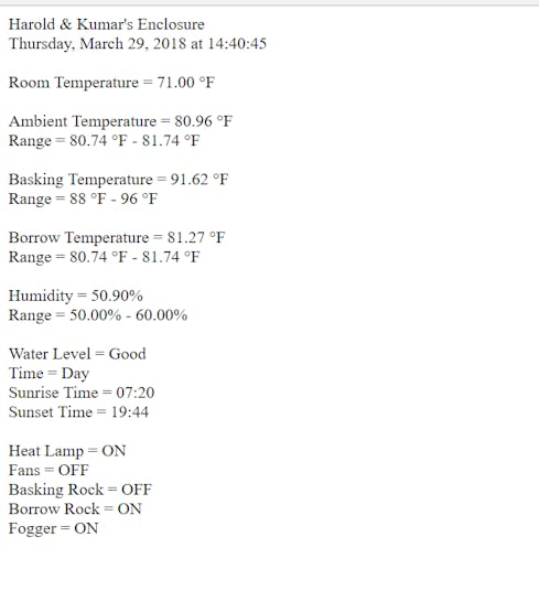

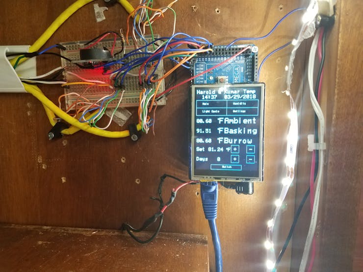

Automated Snake Enclosure with Camera
Interactive snake enclosure that is temperature and humidity controlled and uses lat-long to mimic natural light cycles, with an online cam.
IntermediateShowcase (no instructions)7,976

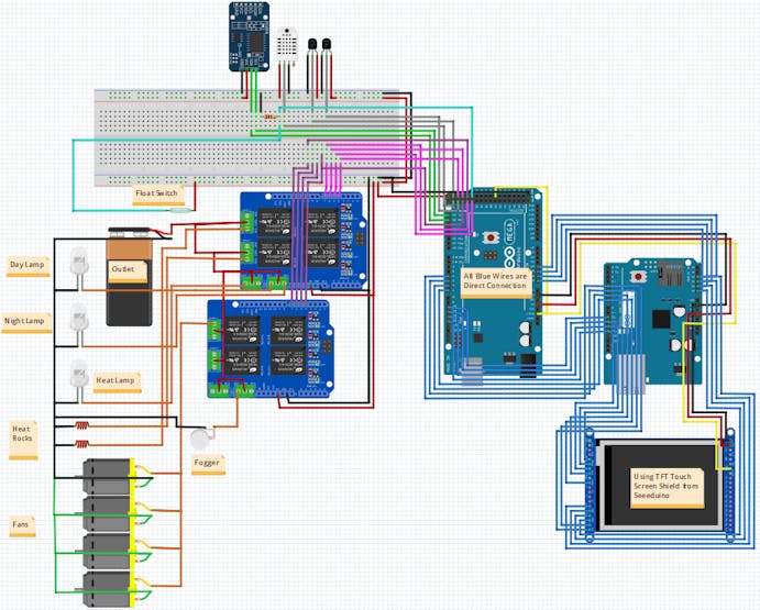

Schematics
Harold and Kumar w/out IP
Fritzing

/*Cat5 wires
  Red Taped ---- Relay Box
  Solid Brown = 5v
  White Brown = Ground
  Solid Green = Pin 7 of always on relay -- Heat Rock 2 Power -- Arduino Pin = 28
  White Green = Pin 6 of always on relay -- Heat Rock 1 Power -- Arduino Pin = 27
  Solid Blue = Pin 5 of always on relay -- Heat Lamp Power -- Arduino Pin = 30
  White Blue = Pin 4 of always on relay -- Day/Night Lights Power -- Arduino Pin = 25
  Solid Orange = Pin 5 of power save relay -- Fogger Power -- Arduino Pin = 26
  White Orange = Pin 4 of power save relay -- Unused
  White Taped ---- Relay Box
  Solid Green = Pin 7 of power save relay -- Fan Relay -- Arduino Pin = 29
  White Green = Unused
  Solid Blue = J1 Open Fan relay
  White Blue = J1 Common Fan relay
  Solid Brown = Unused
  White Brown = Unused
  Solid Orange = 5v
  White Orange = Ground
  Yellow Tape ---- Sensors
  Solid Brown = Fan Power
  White Brown = Fan Ground
  Solid Green = Ambiant Temperature/Humidity Sensor -- Arduino Pin = 22
  White Green = Heat Rock 1 Sensor -- Arduino Pin = 23
  Solid Blue = Heat Rock 2 Sensor -- Arduino Pin = 24
  White Blue = UNUSED
  Solid Orange = 5v
  Red Yellow Tape ---- Touch Screen
  Solid Brown = Top Right ICSP
  White Brown = Analog 3
  Solid Green = Analog 2
  White Green = Analog 1
  Solid Blue = Analog 0
  White Blue = Reset
  Solid Orange = 5v
  Red White Tape ---- Touch Screen
  Solid Brown = Digital 7
  White Brown = Digital 6
  Solid Green = Digital 5
  White Green = Bottom Left ICSP
  Solid Blue = Top Left ICSP
  White Blue = Bottom Middle ICSP
  Solid Orange = Top MiddleICSP
  White Orange = Bottom Right ICSP

          client.println("HTTP/1.1 200 OK");
          client.println("Content-Type: text/html");
          client.println("Connection: close");
          client.println("Refresh: 2");
          client.println();
          client.println("<!DOCTYPE HTML>");
          client.println("<html>");
          client.print("Harold & Kumar's Enclosure");
          client.println("<br />");
          client.print(dayStr(weekday(now())));
          client.print(", ");
          client.print(monthStr(dlstime[4]));
          client.print(" ");
          client.print(dlstime[3]);
          client.print(", ");
          client.print(year());
          client.print(" at ");
          if (dlstime[2] < 10) {
            client.print("0");
          client.print(dlstime[2]);
          client.print(":");
          if (minute() < 10) {
            client.print("0");
          client.print(minute());
          client.print(":");
          if (second() < 10) {
            client.print("0");
          client.print(second());
          client.print("Room Temperature = ");
          client.print(roomtemp);
          client.print(" ");
          client.print(char(176));
          client.print("F");
          client.print("Ambient Temperature = ");
          client.print(ambitempdisp);
          client.print(" ");
          client.print("F");
          client.print(" Range = ");
          if (night == 0) {
            client.print(hkdaytempdisp - .5);
          } else {
            client.print(hknighttempdisp - .5);
          client.print(" ");
          client.print("F - ");
          if (night == 0) {
            client.print(hkdaytempdisp + .5);
          } else {
            client.print(hknighttempdisp + .5);
          client.print(" ");
          client.print("F ");
          if (night == 0 && ambitempday > 0) {
            client.print("For ");
            client.print(ambitempday);
            client.print(" Day(s)");
          if (night == 1 && ambitempnight > 0) {
            client.print(" For ");
            client.print(ambitempnight);
          client.print("Basking Temperature = ");
          client.print(hr1tempdisp);
          client.print(" ");
          client.print("F");
          client.print(88);
          client.print(" ");
          client.print(96);
          client.print(" ");
          client.print("F");
          client.print("Borrow Temperature = ");
          client.print(hr2tempdisp);
          client.print(" ");
          client.print("F");
          if (night == 0) {
          } else {
          client.print(" ");
          if (night == 0) {
          } else {
          client.print(" ");
          client.print("F");
          client.print("Humidity = ");
          client.print(humiddisp);
          client.print("%");
          client.print(humidminset);
          client.print("% - ");
          client.print(humidminset + 10);
          client.print("% ");
          if ( humidday > 0) {
            client.print(humidday);
          client.print("Water Level = ");
          if (digitalRead(foggerwater) == HIGH) {
            client.print("Good");
          } else {
            client.print("Fill Now!");
          client.print("Time = ");
          if (night == 0) {
            client.print("Day");
          } else {
            client.print("Night");
          client.print("Sunrise Time = ");
          if (srhoursetdisp < 10) {
            client.print("0");
          client.print(srhoursetdisp);
          client.print(":");
          if (srminutesetdisp < 10) {
            client.print("0");
          client.print(srminutesetdisp);
          if (srday > 0) {
            client.print(srday);
          client.print("Sunset Time = ");
          if (sshoursetdisp < 10) {
            client.print("0");
          client.print(sshoursetdisp);
          client.print(":");
          if (ssminutesetdisp < 10) {
            client.print("0");
          client.print(ssminutesetdisp);
          if (ssday > 0) {
            client.print(ssday);
          client.print("Heat Lamp = ");
          if (hlpwr == 1) {
            client.print("ON");
          } else {
            client.print("OFF");
          client.print("Fans = ");
          if (fanpwr == 1) {
            client.print("ON");
          } else {
          client.print("Basking Rock = ");
          if (hr1pwr == 1) {
            client.print("ON");
          } else {
          client.print("Borrow Rock = ");
          if (hr2pwr == 1) {
            client.print("ON");
          } else {
          client.print("Fogger = ");
          if (foggerpwr == 1) {
            client.print("ON");
          } else {
          client.println("<div align=center><img src='live.jpg' width='640' height='480'>");
          client.println("<p>");
          client.println("Live from Harold & Kumar</div>");
          client.println("</html>");

  Point p = ts.getPoint();
  p.x = map(p.x, TS_MINX, TS_MAXX, 0, 240);
  p.y = map(p.y, TS_MINY, TS_MAXY, 0, 320);
  if (p.z > __PRESURE) {
