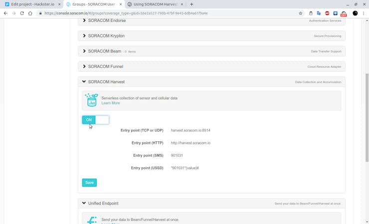

		headers = {'Content-Type': 'application/json'}
		payload = {'temperature': t_bmp, 'humidity': h, 'soil_moisture': soil_data, 'rain_data': rain, 'pressure': p, 'altitude': a, 'pump_on_off': pump_data }
		try:
				r = requests.post('http://harvest.soracom.io', data=json.dumps(payload), headers=headers, timeout=5)
		except requests.exceptions.ConnectTimeout:
				print ("ERROR: connection timeout. Is 3G connection online?")
				sys.exit(1)
		if r.status_code == 400:
				print ("ERROR: failed to submit data. Did you enable Harvest for your SIM?")
				sys.exit(1)
