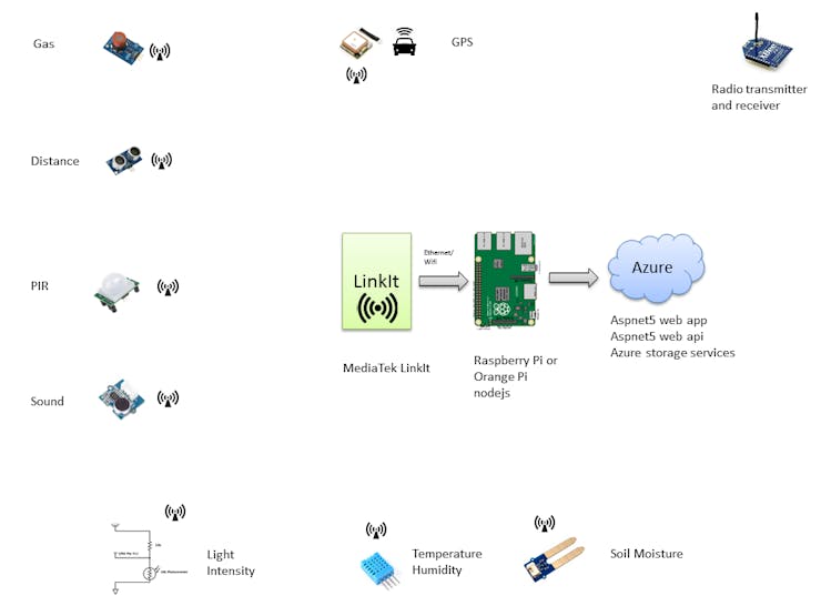

Smart home system using MediaTek Linkit, Xbee, Arduino, Orange PI and Azure

Media Tek as receiver. Sketch to local data to local server

Media Tek Smart home - Source code for data logging
source code for nodejsapp, aspnet5 and mediatek receiver ino
