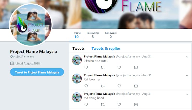

Project Flame: An IoT Mood Lamp for Couples
Project Flame aims to reignite the flame lost over long-distance relationships, by offering a new way to express your emotions via Twitter.

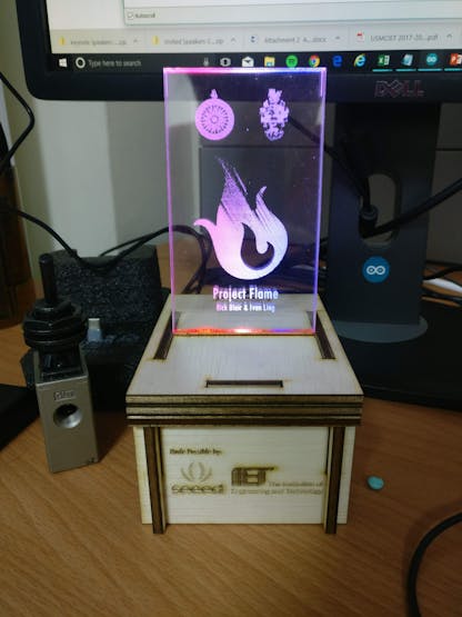

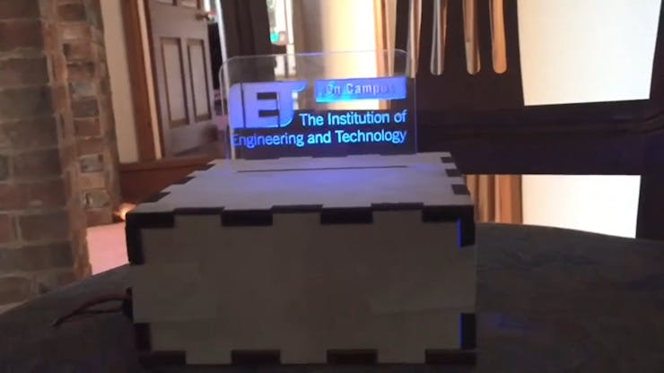

Custom parts and enclosures
Project Flame Laser Cut Parts
Note: All parts are designed for 5mm thick plywood, except for the Bottom piece, which is for 3mm Acrylic. The idea was to let visitors see what's inside the box through the bottom. Feel free to edit it if you like!.
Front Panel
5 mm Plywood. Laser cut.
Quantity needed: 1
Note: Insert your logo on this panel.
Side Panel
Quantity needed: 2
Back Panel
Quantity needed: 1
Note: Hole at the back for USB Cable. You may use 2 front panels if no holes are required.
Bottom Window
3 mm Acrylic. Laser cut.
Quantity needed: 1
Top Panel: LED Holes
Quantity needed: 1
Top Panel: Acrylic Holder
Quantity needed: 2
Optional: You may cut one with plywood and another with Acrylic to make it look nicer.
