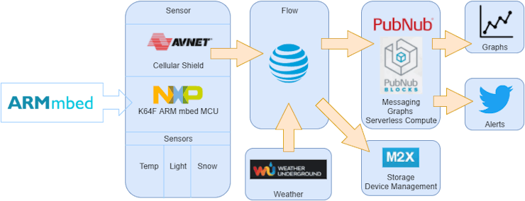

My town of Holland, Michigan has a large snowmelt system. We need a way to monitor its performance over time. IoT to the rescue!
