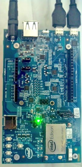

Things used in this project
Intel Edison
Intel Edison
×1

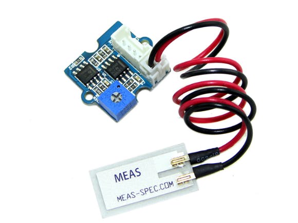

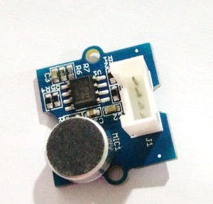

Grove piezo sensor, Grove sound senor
×1

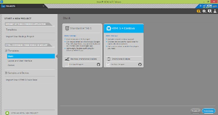

INTEL XDK
Read more
