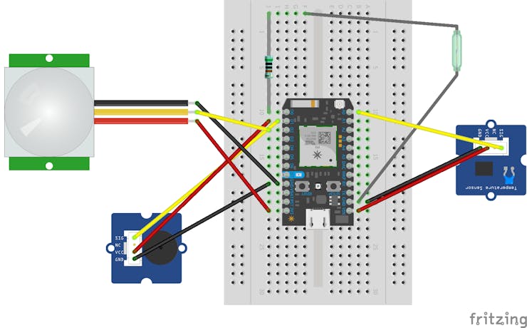

Schematics

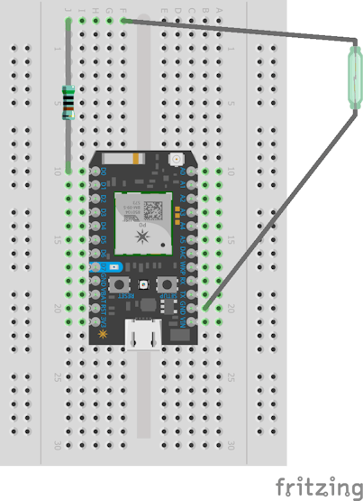

Reed Switch Test
The configuration for testing the reed switch only.
Reed only bb zrglufzucl

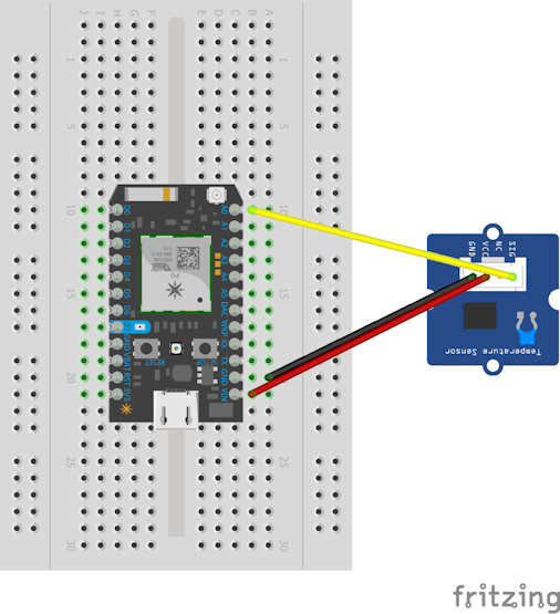

Temperature Sensor Test
The configuration for testing the temperature sensor only.
Temp only bb yvd5g0hp8d

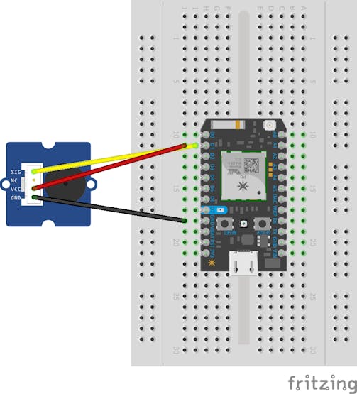

Buzzer Actuator Test
The configuration for testing the buzzer actuator only.
Buzzer only bb fgvloqyfgg

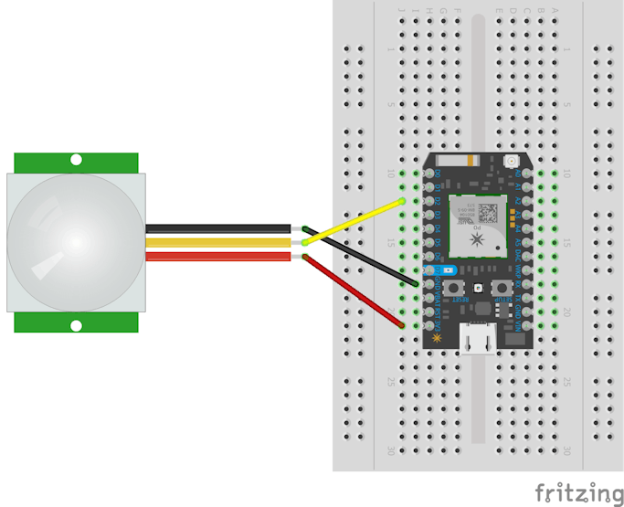

PIR Sensor Test
The configuration for testing the PIR sensor only.
Pir only bb zsqkodbym0
Final Setup
The final configuration.
All bb h58aks9ee8
