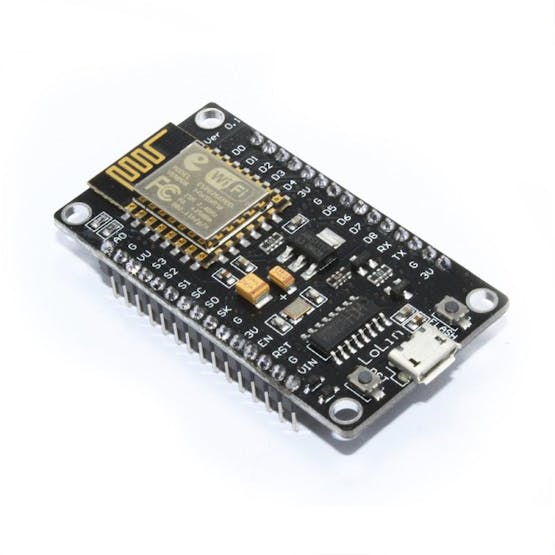

NodeMCU:
NodeMCU is an open source IoT platform. It includes firmware which runs on the ESP8266 Wi-Fi SoC from Espressif Systems, and hardware which is based on the ESP-12 module.The term "NodeMCU" by default refers to the firmware rather than the development kits. The firmware uses the Lua scripting language. It is based on the eLua project, and built on the Espressif Non-OS SDK for ESP8266. It uses many open source projects, such as lua-cjson and SPIFFS.
Features of the ESP8266 include the following:
- Can be programmed with the simple and powerful Lua programming language or Arduino IDE.
- USB-TTL included, plug & play.
- 10 GPIOs D0-D10, PWM functionality, IIC and SPI communication, 1-Wire and ADC A0 etc. all in one board.
- Wifi networking (can be used as access point and/or station, host a web server), connect to internet to fetch or upload data.
- Event-driven API for network applications.
- PCB antenna.
- Wireless connectivity: Wi-Fi: 802.11 b/g/n
- Peripheral interfaces
- Security
- Power management:

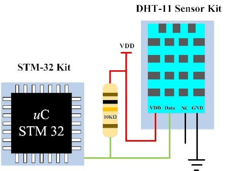

Interfacing DHT11:
The DHT11 sensor detects water vapor by measuring the electrical resistance between the two electrodes. The humidity sensing component is a moisture holding substrate. When water vapor is absorbed by the substrate, the ions are released by the substrate which increases the conductivity between the electrodes. The change in resistance between the two electrodes is proportional to the relative humidity computed. Higher relative humidity(RH) decreases the resistance between the electrodes, while lower relative humidity increases the resistance between the electrodes i.e Relative humidity is inversely proportional to the resistance between two electrodes.
Here we connect the DHT11 temperature and humidity sensor to the digital pin of the STM32.
The analog pin PA0 of STM32 is used for the output signal.
Connections:
STM32 Blue Pill ------------------------------------- DHT11
VCC(3.3v) -> Vcc(3.3v)
GND -> Ground(0V)
PA0 -> Signal
The Temperature and the humidity from the DHT11 is calculated and stored in the variables which will be carried to the next section of the project.

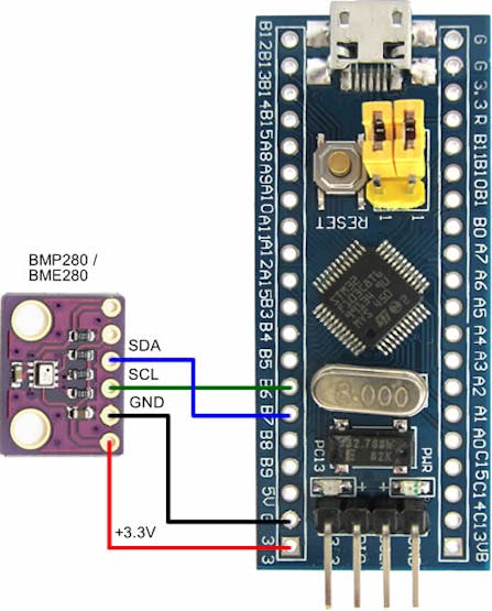

Interfacing BMP280 sensor:
The BMP280 air pressure sensor from Bosch gives the measured air pressure (ambient air pressure) and the ambient temperature as raw values, whereby the output can now be either via I2C or via SPI interface. But also the BMP280 waits with some improvements compared to the BMP180.
The default I2C address of the mapped module is 0x76 and can be changed to 0x77 with a solder bridge on the module.
Here I had used SPI protocol to communicate with Arduino.
With the aid of 12 compensation parameters stored in the sensor, it is possible to determine the atmospheric pressure at the location (station level air pressure), altitude and the ambient temperature from the raw values.

Interfacing MPU9250 Sensor:
The MPU-9250 is the latest 9-axis MEMS sensor from InvenSense®. This replaces the popular EOL’d MPU-9150. InvenSense® lowered power consumption and decreased the size by 44% compared to the MPU-9150. “Gyro noise performance is 3x better, and compass full scale range is over 4x better than competitive offerings.” The MPU-9250 uses 16-bit analog-to-digital converters (ADCs) for digitizing all 9 axes.
The System In Package (SiP) combines two chips: the MPU-6500, which contains a 3-axis gyroscope, a 3-axis accelerometer, and the AK8963, a 3-axis magnetometer.
Connections:
STM32 Blue Pill ------------------------------- BMP280
GND -> Ground(0V)
PB8 -> SCL
PB9 -> SDA

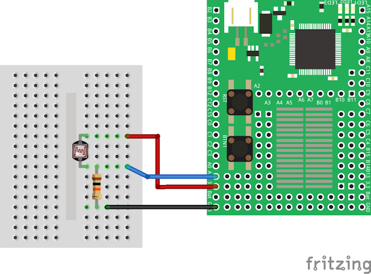

Interfacing Light Sensor:
LDR is Light Dependent Resistor. LDRs are made from semiconductor materials to enable them to have their light-sensitive properties. There are many types but one material is popular and it is cadmium sulfide (CdS). These LDRs or PHOTO RESISTORS works on the principle of “Photo Conductivity”. Now what this principle says is, whenever light falls on the surface of the LDR (in this case) the conductance of the element increases or in other words, the resistance of the LDR falls when the light falls on the surface of the LDR. This property of the decrease in resistance for the LDR is achieved because it is a property of semiconductor material used on the surface.
The digital pin PA9 of STM32 is used for the Output signal.
Connections :
STM32 Blue Pill ----------------------------- LDR
GND -> Ground(0V)
PA9 -> Data

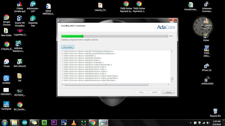

Once the connection is done upload the code for sensors using GNAT IDE.

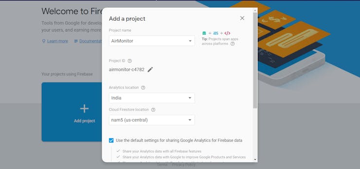

Creating a Firebase Account

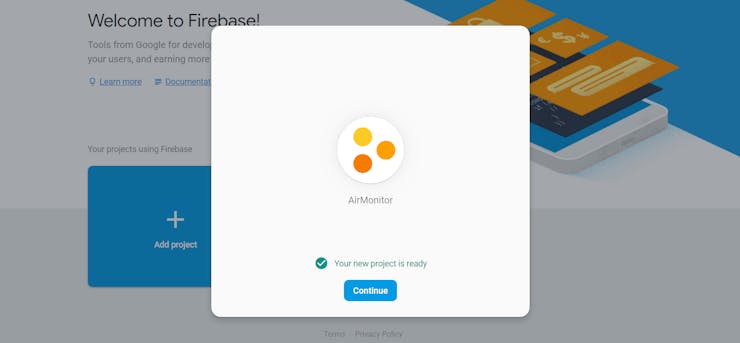

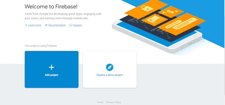

First Login to the Google Firebase and create a new project and and Click "Add project" button to create a new project on Firebase.
Give a name to your project and select your country, Click the Create Project Button to start.
Make sure that you note the Project ID which will be needed later, when you program the hardware to connect to the project.
Now click on Continue to get access the database created.

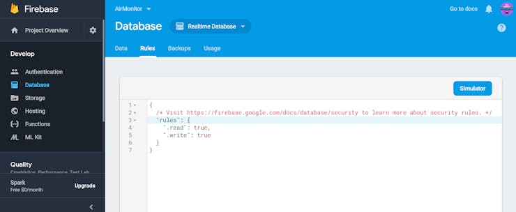

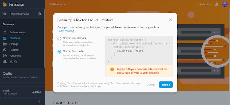

Now Click on Develop -> Database from the side menu, Click the Create Database Button and Start the project in Test Mode as shown below.
Enabling the Firebase will direct you to Data and Rules tab, and verify whether the read and write functions are enabled.
Finally Open Project Settings and copy the Web API Key and the other parameters which will be used in the NodeMCU code.
The Firebase is configured to receive the data from the NodeMCU.

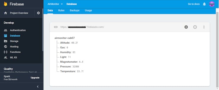

Step 6: Let's See It Working
You can find the data is being published on the Google Firebase.
This data which is logged can be display on either a website or with a mobile application.
