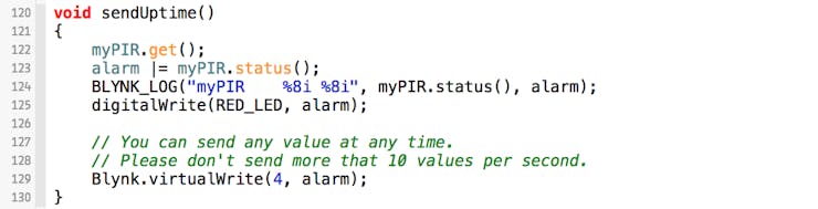

void sendUptime()
    myPIR.get();
    alarm |= myPIR.status();
    BLYNK_LOG("myPIR    %8i %8i", myPIR.status(), alarm);
    digitalWrite(RED_LED, alarm);
    // You can send any value at any time.
    // Please don't send more that 10 values per second.
    Blynk.virtualWrite(4, alarm);

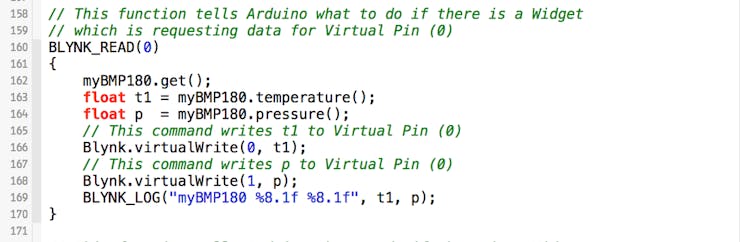

BLYNK_READ(0)
    myBMP180.get();
    float t1 = myBMP180.temperature();
    float p  = myBMP180.pressure();
    // This command writes t1 to Virtual Pin (0)
    Blynk.virtualWrite(0, t1);
    // This command writes p to Virtual Pin (0)
    Blynk.virtualWrite(1, p);
    BLYNK_LOG("myBMP180 %8.1f %8.1f", t1, p);
