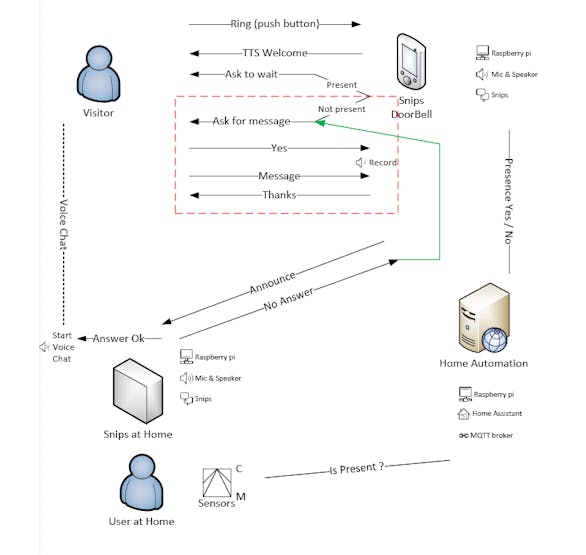

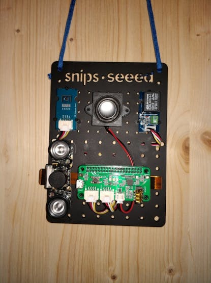

Doorbell & Intercom with Snips Voice Assistant
Doorbell that integrate a Snips voice assistant to say welcome and record messages from visitor when you are not at home.
IntermediateFull instructions provided2 hours1,003
