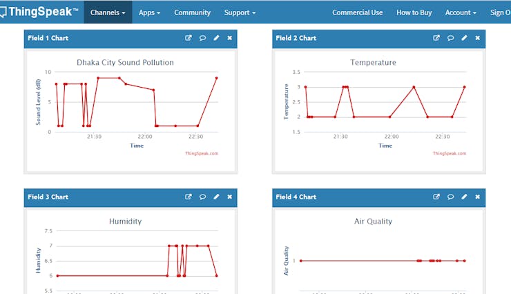

ThingSpeak API
ThingSpeak API

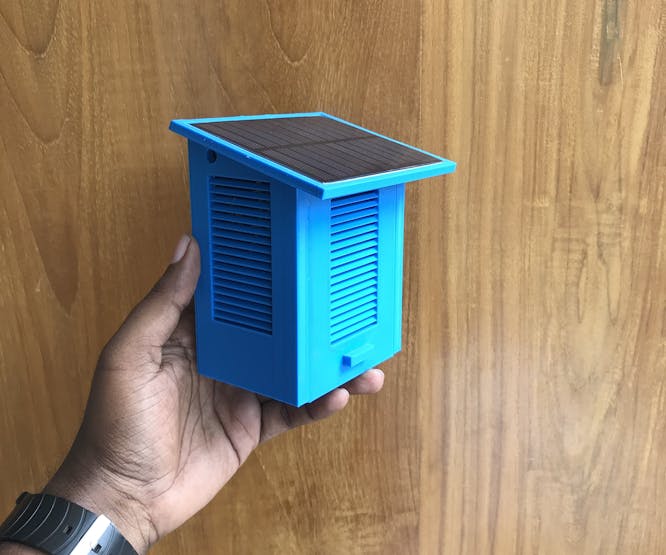

Custom parts and enclosures
Main Body of the box
The original design was made by Thingiverse user deba168. I modified the box according to the size of the solar panel. Thanks, Mr. deba168 for his nice design.
Front Cover
The original file was designed by deba168.

//this function sends data to ThingSpeak server
//it takes approximately 13 seconds to send data to server using GPRS
