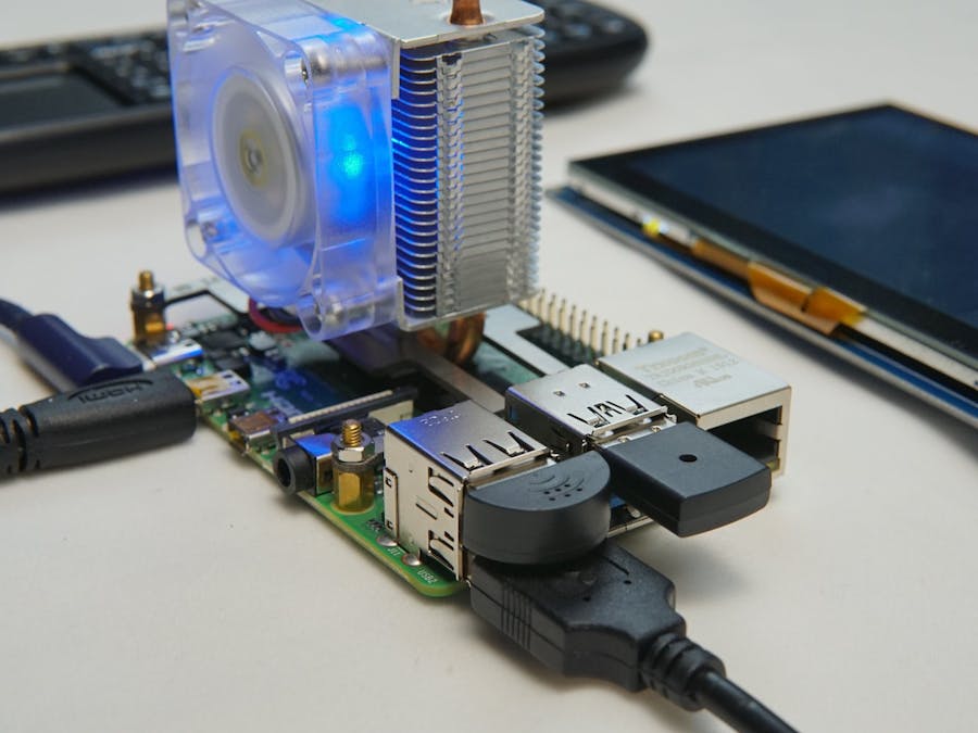

This is a program that runs on the Raspberry Pi. I used the Raspberry Pi 4B and the Mini USB Microphone to record my own voice using it.

1、 Open the Raspberry pi (you need a display or use SSH to control pi) , Teminal and input the code:
SH
arecord --device=hw:1,0 --format S16_LE --rate 44100 -V mono -c1 voice.wav
2、 If your recording is over, you can use Ctrl+C to exit recording. And if you want to look for you
SH
ls
3、 After recording is complete, you use the code below to open your voice.
SH
aplay --device=plughw:1,0 voice.wav
