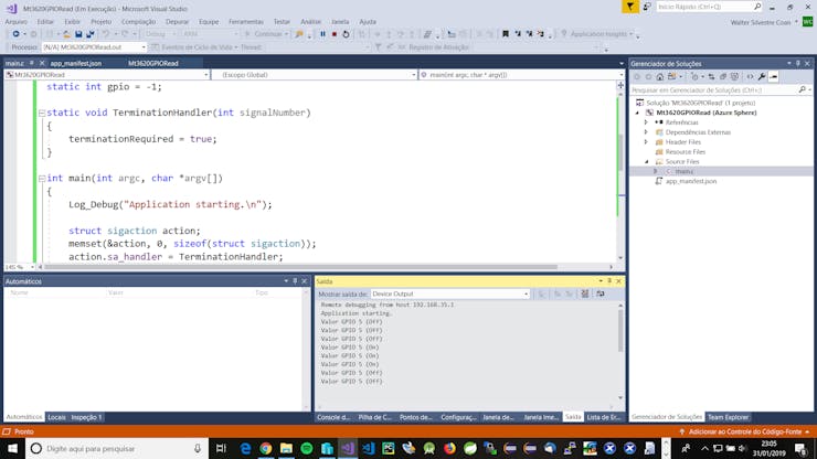

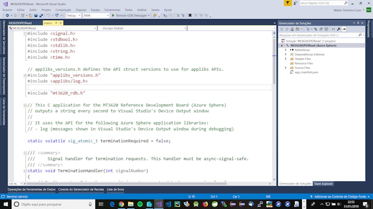

Reading GPIO Value From Microsoft Azure Sphere
This is a simple example demonstrating how to read GPIO from Microsoft Azure Sphere.

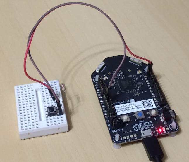

Things used in this project
MT3620 Development Board for Azure Sphere
Seeed MT3620 Development Board for Azure Sphere
×1
Resistor 1k ohm
Resistor 1k ohm
×1
Pushbutton switch 12mm
SparkFun Pushbutton switch 12mm
×1

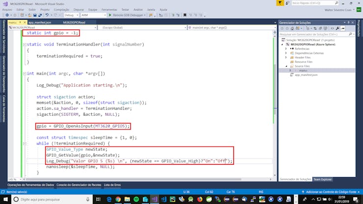

Code
Mt3620GPIORead
Mt3620GPIORead
